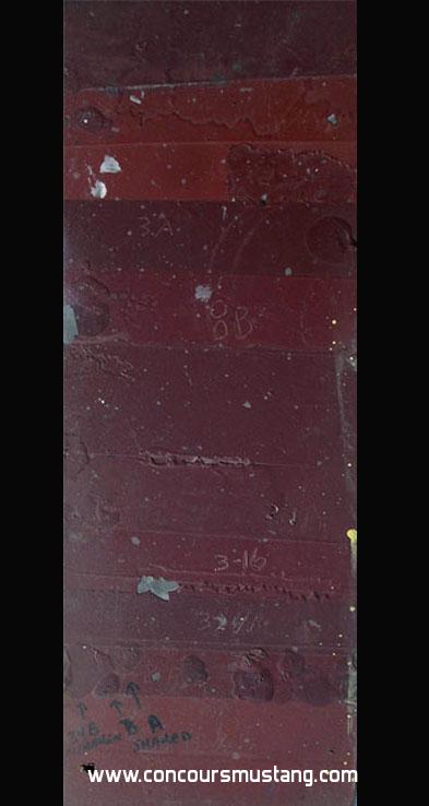

Just to get an idea what I am working with, here are a few shots of the problem areas, before too much stripping of the surfaces.
You can see the dolly hole that has been welded looks to be welded after the primer/sealer bath. Then you see some stretching or elongated holes at the other center dolly holes. The very front two dolly holes below the radiator and the two back near the rear bumper look normal.
« Last Edit: June 27, 2014, 09:12:38 AM by 67gtasanjose »
You can see the dolly hole that has been welded looks to be welded after the primer/sealer bath........
Bath??   Cheap cars like Mustangs didn't get dipped in primer sealer like the more expensive larger car like T Birds
As for the damage - looks like hundreds I've seen - got tome work ahead of you
OK, probably wrote that out wrong, the application is such a soaking, maybe I could have written as primer/sealer "shower" to be more accurate.
Jeff, what do you make of the dolly hole damage? In particular the way the holes are stretched and also the repaired (welded) one? Obviously, the damage can all be worked out, but could that damage have occurred on the line somehow?
As i mentioned in a previous comment, I am sure 100% sure this car hasn't made it's way onto any frame equipment that might have used those holes for alignment or pulling purposes.  I myself, have been responsible for all repair and repaint (the good, the bad and the ugly) along the way. This car had all original, un-repaired panels when I first got it, with every shopping cart scratch, ding & dent that 10 years could give to any unrestored original vehicle used in (unloved) daily driving. No sign of fading/unmatching paint touch-ups, or any panel replacement before me, and today, all date codes consistently match on the car, with the only exceptions being parts I know that I have changed. (known original fender, door, hood, quarter-panels, rear valance etc., all have consistant date codes)
As I said, I will more than likely repair all of the damaged areas anyways, but this particular area of damage doesn't seem to match the vehicle history I have on the car by any means. It seems the only explanation I could possibly imagine as having occurred on the line. Maybe not the only one, maybe it is, IDK, but there it is and damage to all 4 holes, 3 rather significant and one to the point of needing welded.
