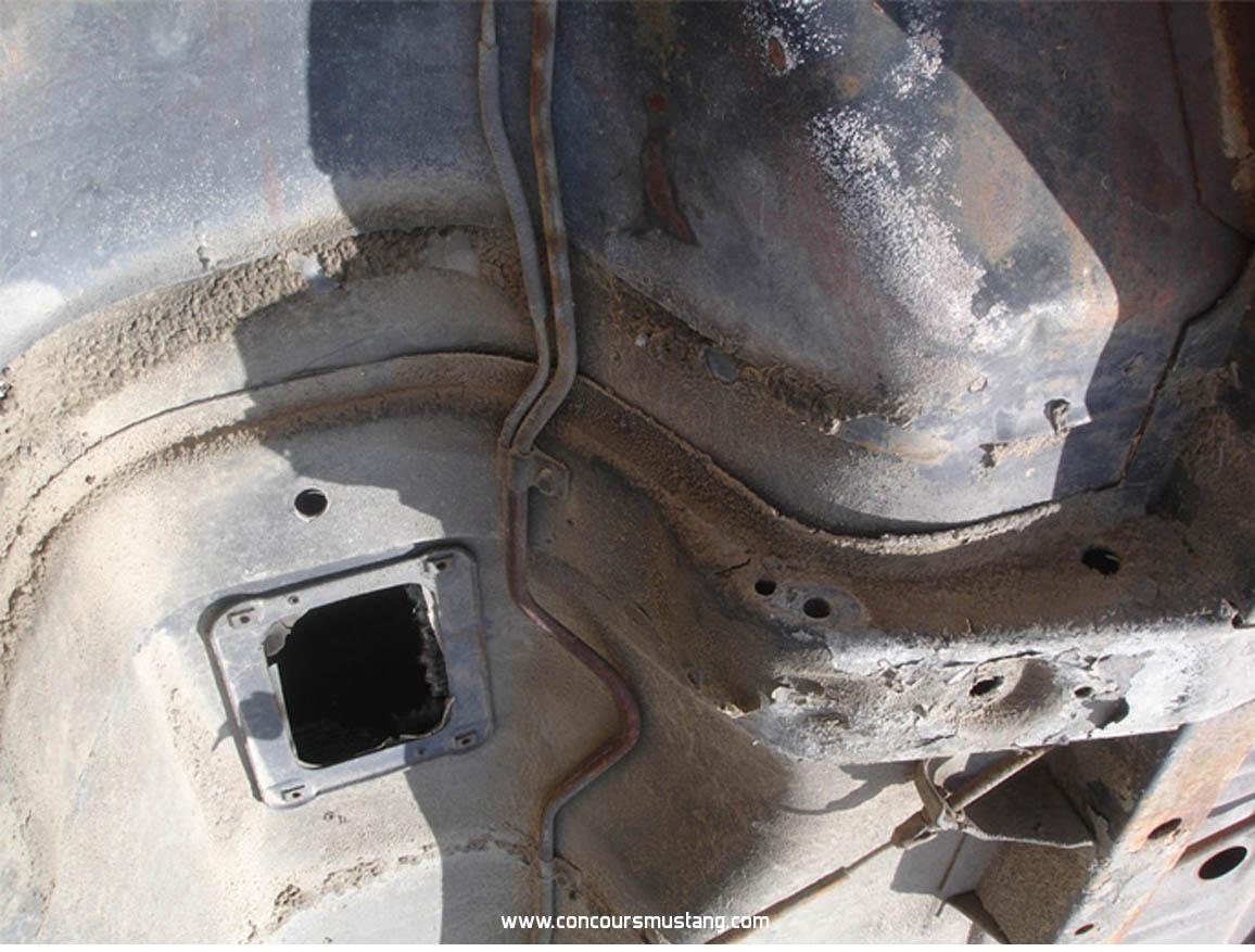

i did post on the 65-70 shelby forum but i'm asking for any underneath pics of the 70 gas tank vapor line used for calif dso'd mustangs.  got one from npd but not sure how it goes.  for a 70 gt500  thanks  email any pics  to  daveandkirsten@shaw.ca

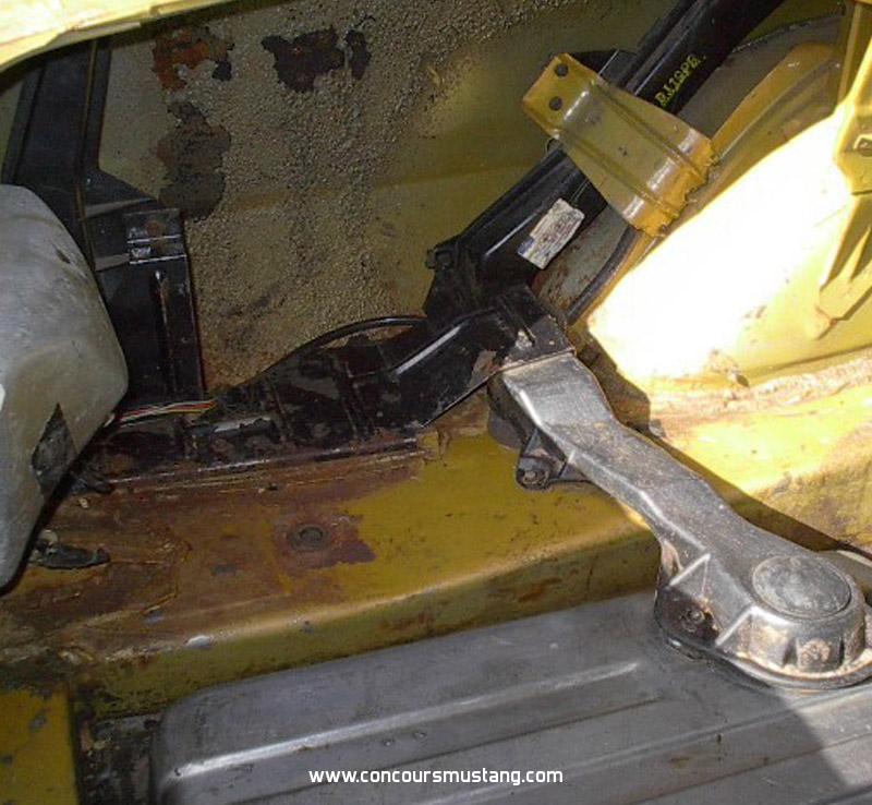

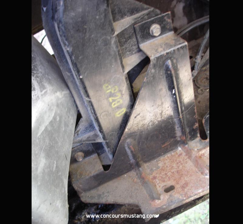

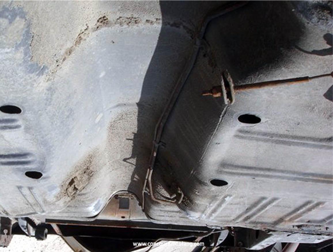

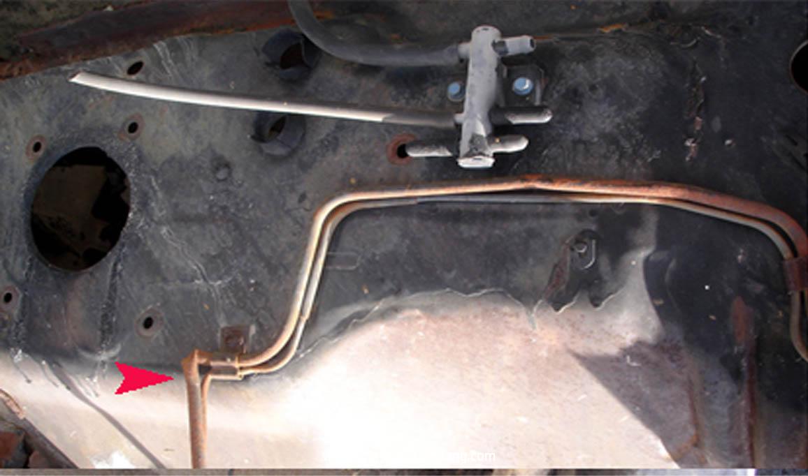

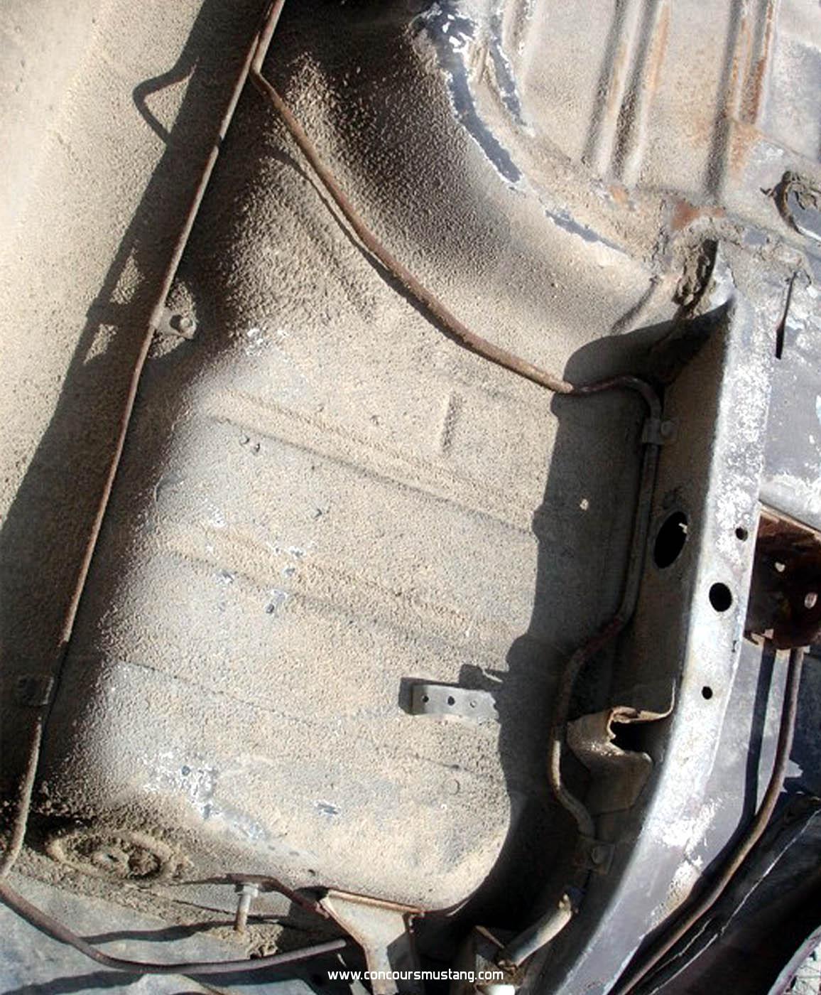

We'll post here so that future members can find them if they have a need. Was luck a while back to find a 1970 with the Calif Evap system rolled over on the roof in a yard  ;D
As mentioned in the other thread its very likely that the Shelby addition of the lines would be different than the ones installed at San Jose but these may help you in some way
From front to back - starting at firewall so I'm not including the flex line forward to the charcoal canister.
In this line someone bent over the solid line at the passenger end :(  - arrow
Hope this helps

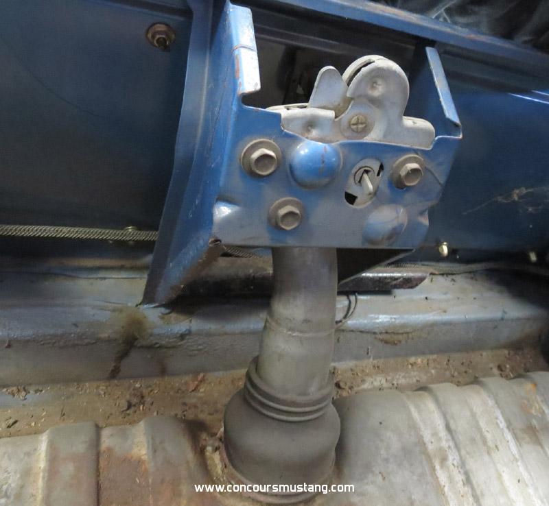

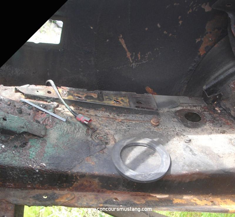

« Reply #2 on: February 14, 2014, 11:40:34 PM »

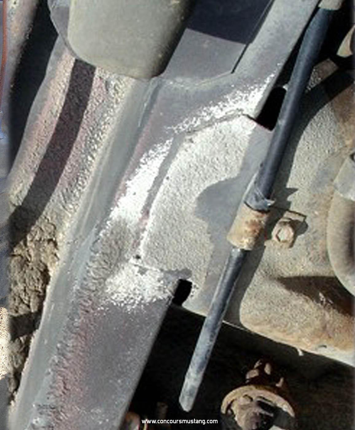

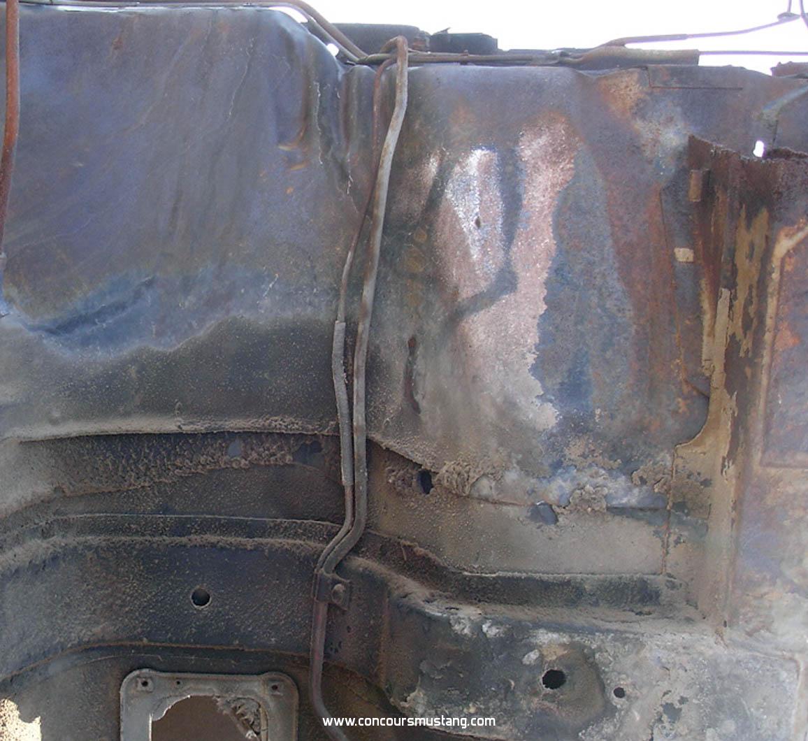

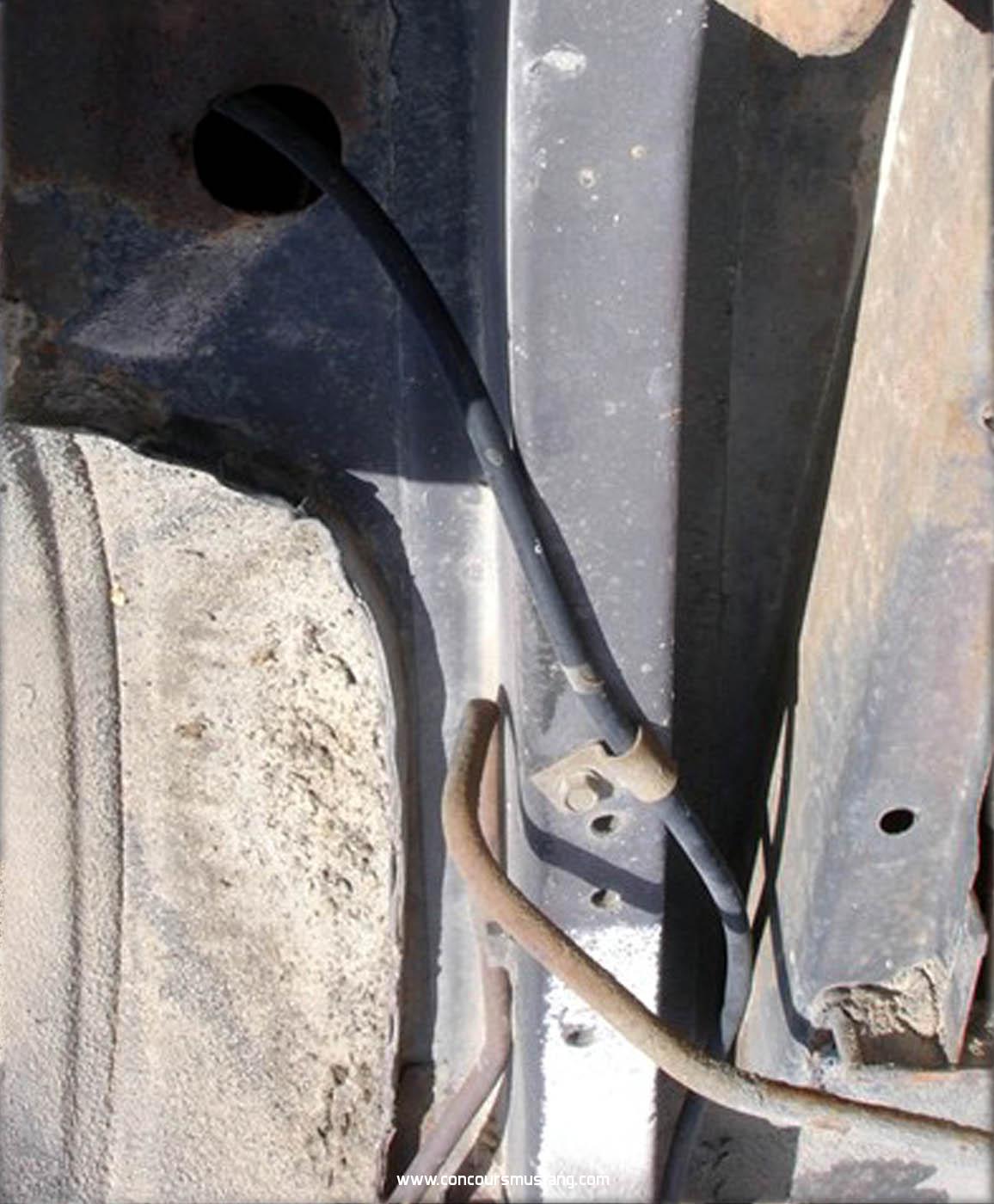

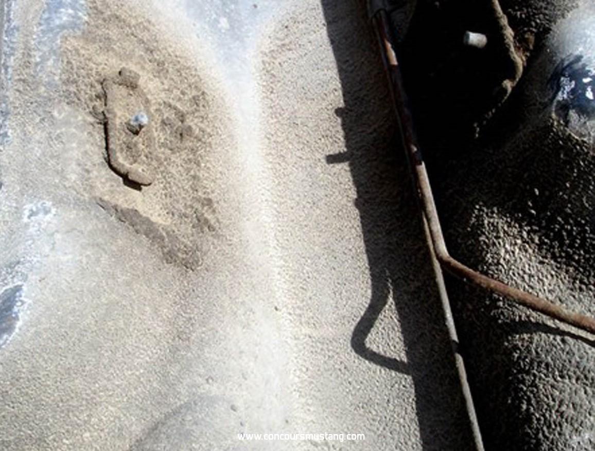

To complete the picture - evap lines from tank to engine compartment I offer the following
In some of the pictures the lines in the passenger rear inner fender area have been "moved" a bit so adjust accordingly - those were wrecking yard shots.
It appears that the single plastic retainer used at Dearborn was the black one and the white was used on San Jose built cars from the examples I have
Hope this helps
From the transmission tunnel to the charcoal canister
