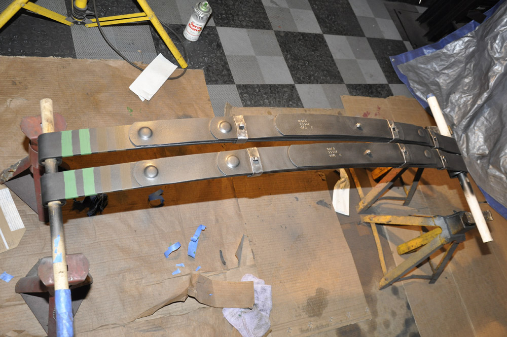

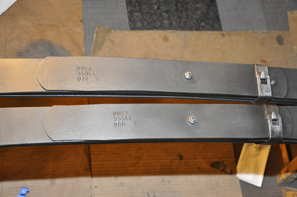

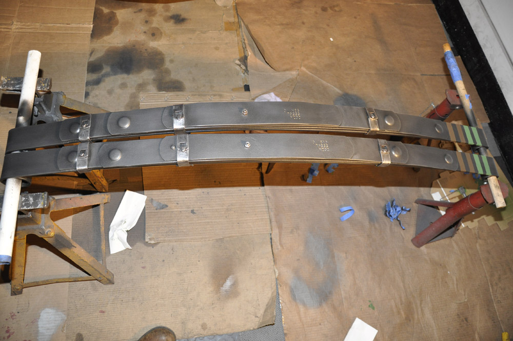

Here are some pictures of my 70 B2 leaf springs that I just restored  thsi past weekend with Jeffs approach of Eastwood Phosphate, then a dusting of Charcoal Metallic, followed by matte clear. I also hit it with a scotchbright in the end to reduce the shine a bit more. I drive this car (actually all of my cars) lots so opted to go with painting the springs. I did the same a few years ago on my 70 Mach 1, and as mentioned the only areas that "show wear"  are on the  edges where the springs rub together. Touch-up has been pretty easy with a quick hit of phosphate paint and then clear after masking the area off while on the car.
I think they are close to a phosphated color, but not perfect. Thoughts? (I would put this into Concours driven)

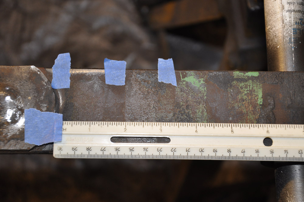

Also included is a pic of the original stripes for a reference. The Brown stripes can be seen between the blue tape areas if you look carefully between  .5" to 1.5" and 2" to 3".

Looks good, almost too good. The ID stripes were not put that neatly. Keep in mind that the "painter" was reading a shipping manifest, selecting the correct paint and "painting". The total time would be less than a minute resulting in a jagged edge of the stripes, slop over at the top and bottom of the stroke and uneven spacing.
(Think - hung over, maybe stoned, worried about what the favorite sports team will do, and watching the clock.)

Might have gotten the clear on too smoothly - purpose of the dry coats since this can produce an almost texture like there is dust on the surface. Glad you figured out something that worked for you.
How did you finish the clamps?  Wire brush?
Looks good - judges will likely (unless something catches their eye) 15-30 seconds asking themselves if it looks right? anything odd? and then move on.
I can see the waves in the stripes - think your find there.
Yes I wire brushed them.  First with a course brush to get them somewhat clean, then soaked them in evaporust for a few days, then a fine brush and then cleared.
How do you typically finish the clamps?
Use to wire brush everything but found that it left a finish that was too bright and didn't look like new metal. IF you go to any hardware store and look at the bare steel bulk metal (1 or 2" wide strap or bar) you get an idea of the finish you looking for. Now I often wire brush but them come back with the liquid gun bluing repair fluid (normally applied with steel wool) then work the surface to brighten and make the finish consistent then oil or dry clear if you choose.
Have found that you can oil over paint with no issues other than making it a bit more difficult to touch up if needed later
Need to do an article for the site showing the process I guess. Pictures with words work so much better
