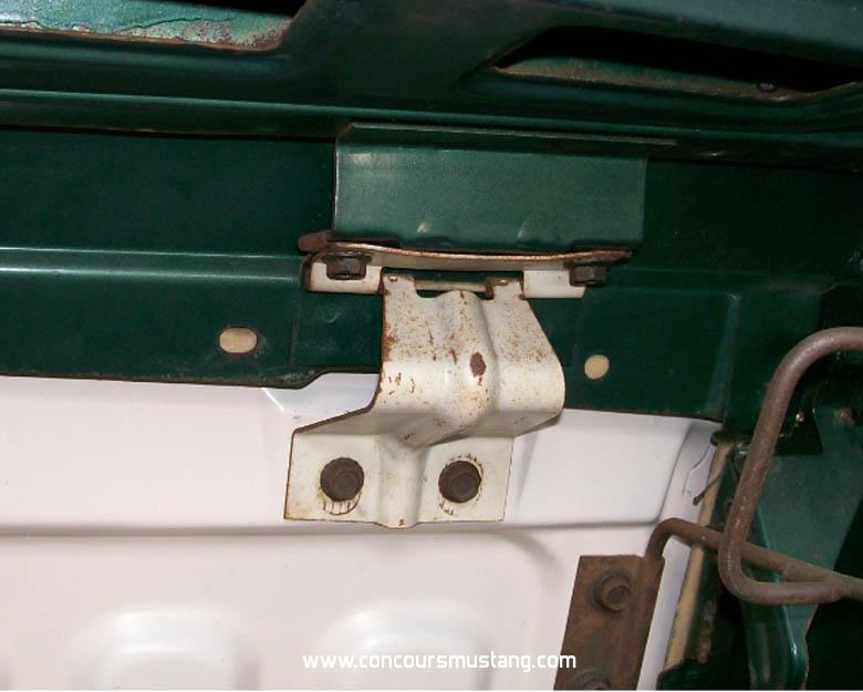

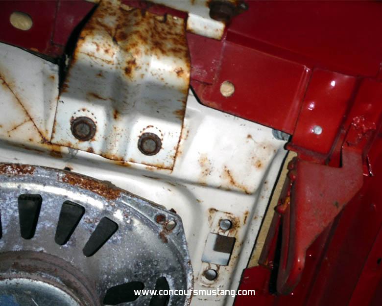

This is what I've always seen on unrestored 67 San Jose examples (posted a number of times in other threads. Believe the zinc ones you recall were likely on "restored" cars and likely not original. Ones I did find that used zinc bolts all had been repainted at least in the trunk, had other hardware plated incorrectly and sometimes had 68 trunk lid hinges  ::) After looking through allot of examples it appears that at some point reproduction hardware suppliers or owner/restorers just started copying late 66 fastback latch hardware. Maybe it was the only available thing available in that retail space or came with the latch kits (included)
The ones below appear to match (the finish ) of the rest of the hardware used to mount or hinge both fold down and non- fold down trap doors that year

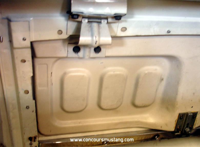

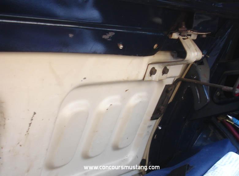

66 Trap door latch examples. Notice the bolt head design is different also when compared to 67 version
Note: As usual only looked at unrestored cars and cars without the trunk repainted examples
7R1518xx
7R2071xxx

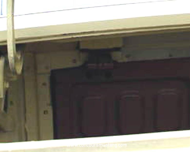

More - At a point I got tired of recording and collecting data since they all were coming up the same - lots and lots of pictures to go through.
 So I finally just focused on Dec 66 San Jose production and offer the three examples shown below..

Thanks Jeff. Regarding Q1 it looks like I have screws like 7R1518xx.  They include toothed washers.   The 7R2071xx ones look to have a much larger flat washer, possibly part of the head.

Comparing a couple of the best pictures as you did.  Looks like two different (slightly) different head sizes bot the same finish and believe both were bolts since there are thread inserts in the door. Believe both version have the flared/washer based head on the bolt
For the latch itself, if you are thinking that it is, or isn’t, zinc plated.  If not what finish would you think is correct?
Gone back and forth myself on the original finish. Have some that looked more galvanized (not heavy pattern like trunk lid or door latches but its a much smaller sectioned piece except for the back side) while others have a more uniform finish as a dull clear/bright zinc. Of course all are aged so it makes it more difficult to be certain
Don't have any 67 ones currently to look at or to test for the original plating. 7R2071xx example sure looks more like a dull zinc or cad now after all these years. Like the examples of the 66's
