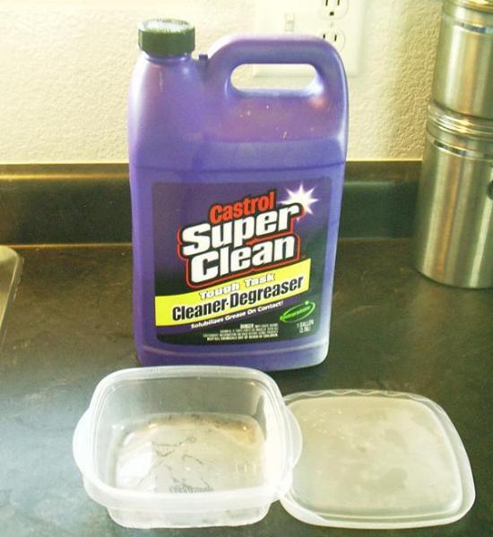

Thanks.  It was a little bit time consuminq but here`s my steps:
1)  Completely Disassemble
2)  Pressure wash multiple times with this
3)  Scrub multiple times with a stiff bristle brush and lacquer thinner
4)  Wash several times in the kitchen dishwasher with liquid Cascade
5)  Media blast very thorouqhly with walnut shells
6)  Spend hours and hours brushinq with a stainless steel bristle welder`s toothbrush until the finish I wanted was achieved
7)  Wipe with a raq usinq PPG Concept Satin Clear so that its pushed down into the surface profile of the aluminum but most is wiped off.
