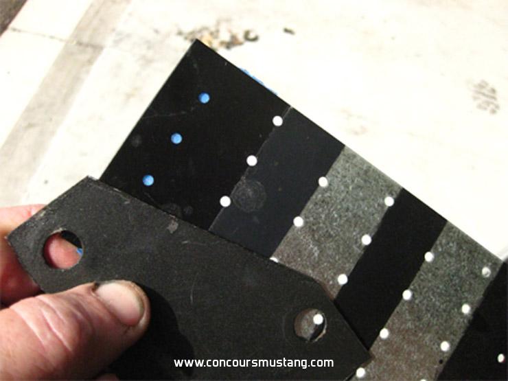

Since products are always changing some of us invest a little from time to time to just buy 4-8 different rattle cans, spray them put on a section of metal (I've used a nailing plate often for mine) in one to two inch strips next to each other to compare to original finishes and choose from during a restoration since all of. the black finishes originally were not the same
Also I will test during the process to see which hold up to baking which I've done to make the finish hold up better IMHO over the long haul
Each is labeled on the back side
Just what has helped me in my tasks
