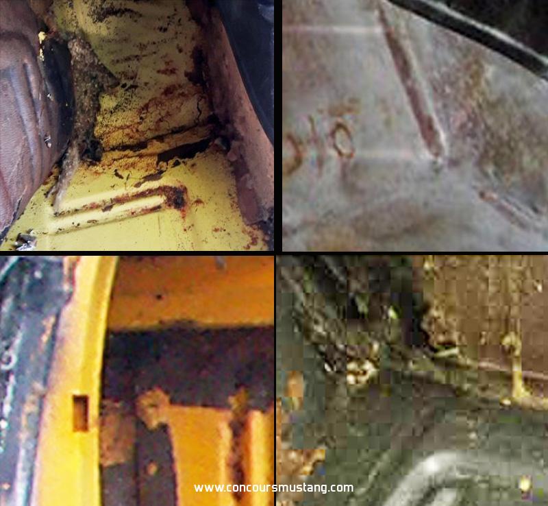

It?s still a pretty small area to run my air punch.  Found this on another thread.
