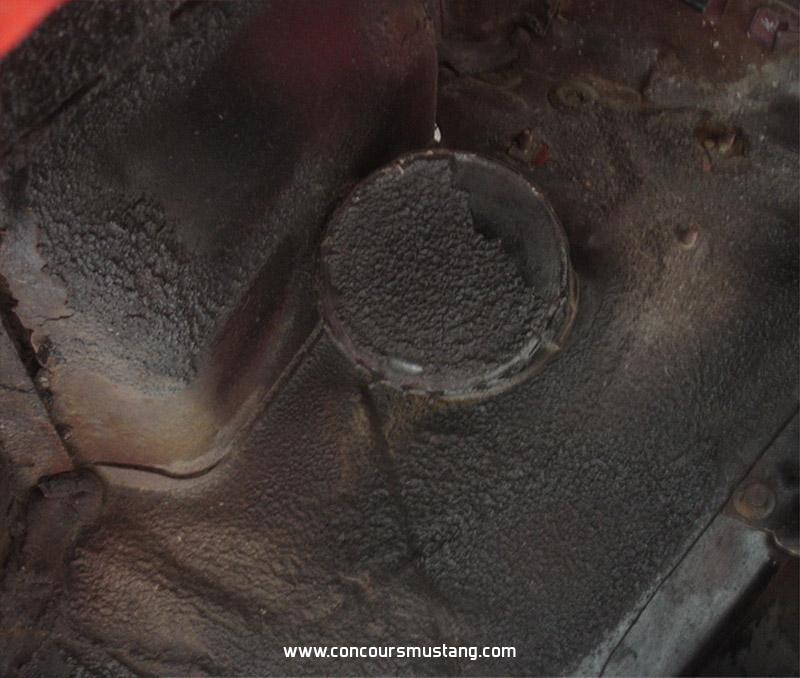

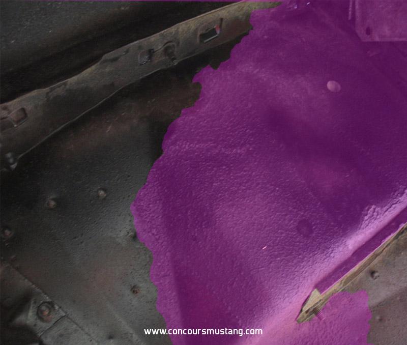

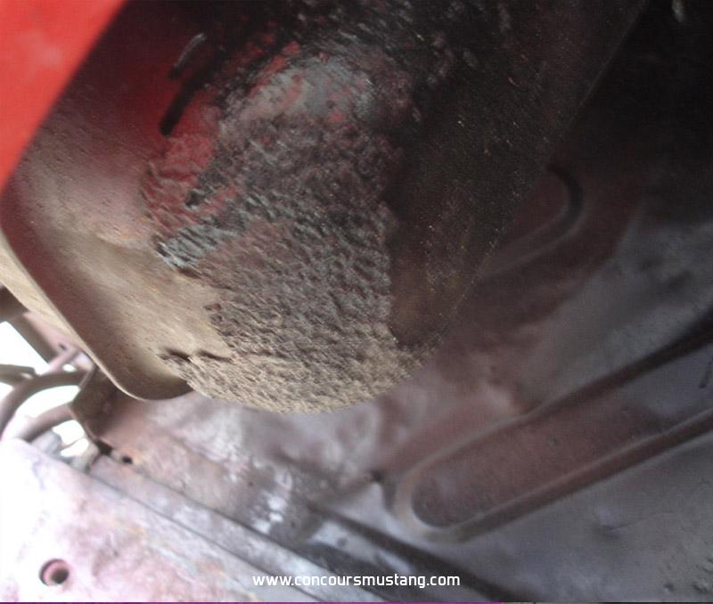

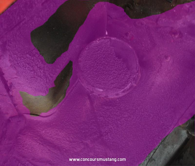

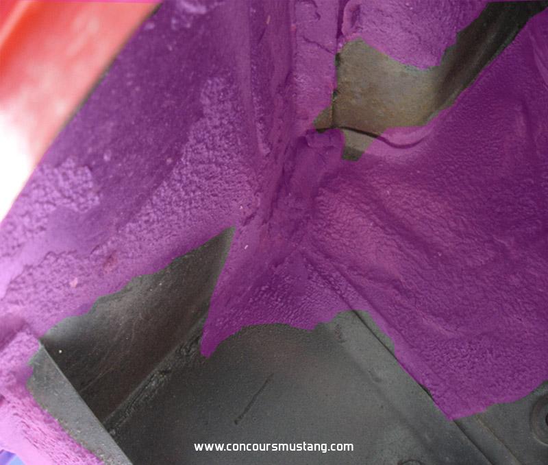

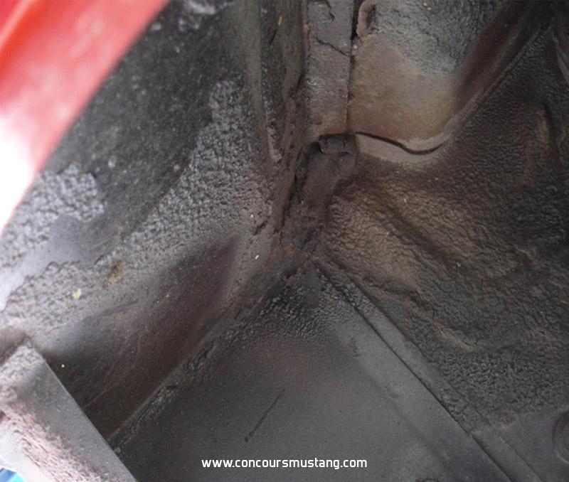

In any case here is a 68 Dearborn Cougar example showing that IMHO Cougars did not receive any more sound deadener in the front wheel wells than Mustangs. I attempted to trace as best I could what appears to be the original coverage and pattern of spray application. If you want more and will accept Mustang examples I can post additional pictures of course
All this is helping us test out the new software
Passenger side rear
Slightly below the above area
Battery tray/box area - PS front
Not much for the drivers side (didn't take these) The drivers side front appears to have been in an accident (maybe why there is more than one picture) and it appears all the sound deadener got knocked off the inner panel from the attempts fo body work but  the picture does show some sound deadener on the back side of the headlight buck surrounds in the front fenders
