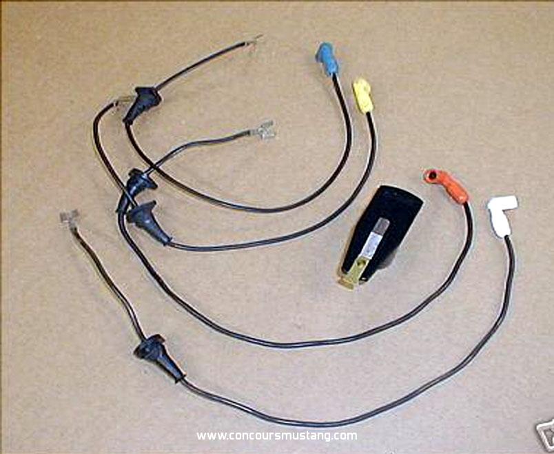

I was researching the correct end for my 67 Hi-Po and Mannel states 65/66 cars used an eyelet on the distributor primary wire that could fit through the small hole in the distributor. This small hole eyelet primary wire continued on in 67 on Hi-Po 'FoMoCo' cast  distributors (although the later Hi-Po Autolite distributors and service replacements went big hole).
However, in 67 all vacuum advance distributors went big hole due to the primary distributor wire's 90 degree molded end.
In ChrisV289's picture he shows an eyelet and a yellow 90 degree connector on a 65/66 car's coil.
I think this means the yellow connector is going to a 67-up distributor on Chris' car and that the normal nut screw down for a 65/66 distributor primary lead is instead the ignition power on this car.
Do I have this right?

Right, it had to be 67 or later to have a hole big enough for the yellow connector. Or someone made the hole in the distributor bigger with a drill.
Just for kicks, can you measure the length of the wire? From where it contacts the distributor body to the beginning of the yellow connector?

I had asked Chris to measure his yellow 90 degree distributor primary wire only to determine the lengths of the various years. And, as we know, if the distributor had a molded end it could not be a stock 65/6 distributor.
I agree that all of the "FoMoCo" cast Hi-Po distributors were small hole and had the eyelet. I pulled out a variety of distributors which still had an original "appearing" primary wire with results below:
Year        Part No       Date      Length      Identifier
65/6       Unknown                 15 1/2       Eyelet (two samples of this length)
67          C7ZF-F       7A20       8 1/2       Yellow
67          Chris'                        8 1/2       Yellow
69          C8OF-C      7H16     14 1/2       Lime? Yellow
73          D2ZF-CA    1K22      12 1/2      Orange/Red
My HiPo distributor was converted to Petronix and is missing its wire. I'll just buy the 65/67 289 Hi-Po eyelet style repop wire.
