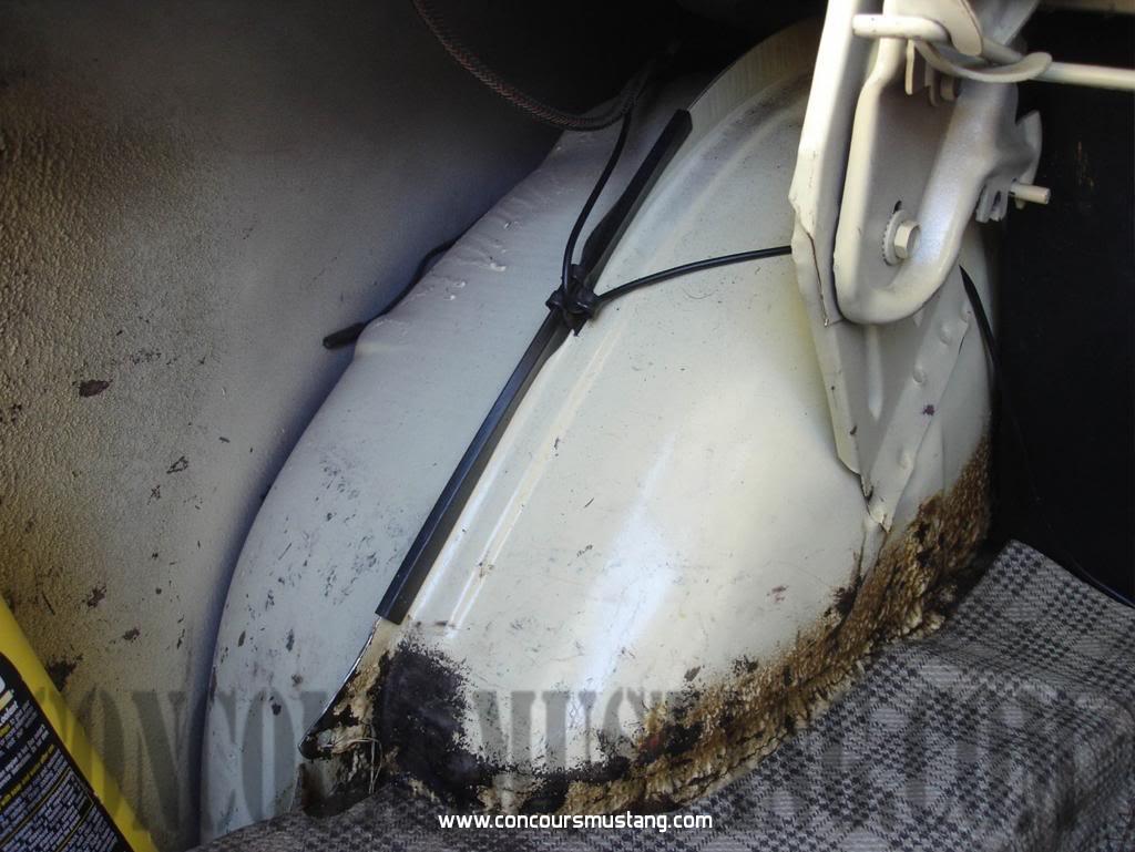

Hello,
Does anyone know some details about this clip?
- name/number of the clip?
- manufacturer/source?
How is this clip fixed/mounted on the metal folding (hole)?
Thx
Ralf

Are you questioning if your car should have this?  Looks like yours is a convertible, but this pic is a fastback.  Also, do you know when/where the car in the pic was built?  Best to know for sure if this applies to your own car before copying details.

Initially, I thought it was that clip too, but when blowing up the image, it doesn't seem like it is.

Your picture shows the most typical version that I have seen in observations of 67 SJ fastback trunks.

My NOV 66 Shelby has a different clip than this. It is plastic with a  spring steel interior.

Keith, that is the clip I was looking for. Thank you.
Is there any source available to get this clip?
Also thx to the others supporting me on this issue.
I'm a bit confused, because I have asked a question and used a pic, which is not related to my car.  :o ;D
