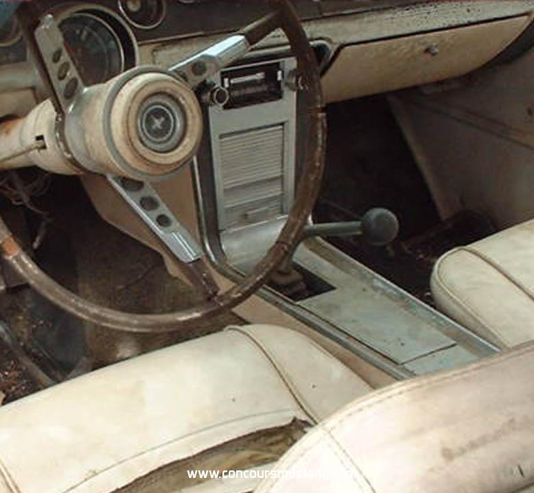

Yes that does help. The car didn't have that trim ring and the carpet was in pretty bad shape when I got it. Also one of the things I didn't document that well with pictures - seem to have a much better feel for what to take pictures of now :P. Would still like to see a shot of a finished 4 speed console if possible. Thanks.

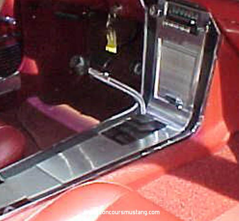

....... Would still like to see a shot of a finished 4 speed console if possible. Thanks.
Not sure what details it will provide but here you are
3 Speed example

This states that it was used in Mustangs without a console.  Also states Cougar would have used something a little fancier, and they offer that, but again states non-console car.  I know I test fitted my console over the carpet to see how things were going to fit, being that the new underlays are no where near as thick these days than original, and I am not using the mass backed carpet.  There is a pretty good gap between the console bezel, and carpet, and I am sure that back in the day that didn't all get sealed up.  Black hole  for stuff to fall into :)  I doubt this piece would fill all that.  Not positive either if it would fill the whole rectangle opening of the top bezel either, but I don't have one to try, unless I buy one.  J_Speegle, like the pics attached.  These old consoles are cool and artwork themselves IMO!  Just would like to see a more detailed picture in the "Black hole"
