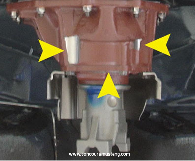

The yellow blob near or on the fill plug is the most consistent of the different center section markings seen IMO . The yoke dust shield was bare steel because it rusted so typically. I have had unused ones on NOS replacement yokes. That bare steel look is what you want . The best way to achieve and maintain that bare steel look may depend on the intended usage of the car.

Don't have any original 68 9" with a yellow daub near the filler  - just what I've got records and pictures of.   To the interior of that location do have one marked with a pink daub to the inside of the fill - could be that workers used multiple different colors like we find in the application of the inspector and assembler IDs. Have a few with yellow in the "casting rib box" (towards the inside center again) above that (with the fill point) "rib box"
I've found more often for this year and application yellow on the yoke like we saw in 66  sometimes mixed (findings not certain it wasn't done on all) with the blue spray on the washer - often continuing a very little onto the pinion retainer.   Assembler and inspectors numbers on the passenger side and top upper "rib box"
Markings on the bottom of the third member are the most difficult as they are often damaged by running over things and jacks over time. Handful of different colors used and pattern IMHO hasn't been decoded as of yet

Thanks Bob, I have fitted a new Currie yoke that seems pretty much identical to my old Ford 1330 long/wide yoke, with the exception that its not missing a big balance drilling. I thought that wise for a driver as the old yoke wont be paired with its old driveshaft (beyond repair). I'll mask and spray it in VHT chassis cast iron. That gives a reasonable bare steel look.
So it seems that either a blue spray or yellow blob was used on the factory yokes? And perhaps a yellow blob by the filler. Perhaps that will have to do.
There is plenty of detail for finishes on the web for Metuchen CJ rear ends, thanks to the like of the Coralsnake etc.
But sadly little on 390 GT cars of the same year and plant.
But I'd rather not draw all over mine unless I know it to be correct.
Thanks for the help. Both Bob & Jeff.
I would use a stainless steel type paint rather then a cast iron type paint .Ether is readily available but stainless steel paint looks closer to bare steel relatively speaking IMO.
Would instead go with a yellow daub/spray dot on the yoke and a blue spray on yoke, washer and onto pinion retainer if your going to reproduce the original markings
Transmissions and rear ends IMHO were the most marked parts installed one the cars. Since they were subassembles that were attached to other sub assembles they tended to get marked by plenty of workers who built, attached or checked different stages. Agree that sometimes it best to leave marks off unless your certain and they originally came from that specific assembly. With that said its not uncommon to find around ten separate marks on a third member  Have about 800 examples of markings from 65-73 rearends so have been collecting and comparing for a fair amount of time ;)
