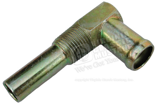

  • Posts: 24818
Re: Distributor finish
« Reply #9 on: February 24, 2016, 05:55:30 PM »
cap holddowns are p& o. the retainers are olive drab and the screws zinc.
+1 Would call the pin more of a greenish/gold finish similar to ported vacuum switches, Thermactor T fittings and back fire valve main bodies. Finish didn't hold up well over the years. Examples are NOS (not rebuilt) units boxed in 1968 or 69
Mounting screws depends on what year as you can see in the pictures below
Advance attaching hardware P & O
Advance attaching hardware zinc. (Don't just copy the paint marks - they likely don't match the ones that should be on your car -  :o
