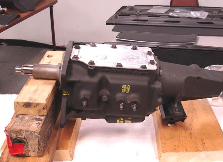

for everyones help. I really would like to get it back to looking like this one that's attached in the picture

that one does not have the correct appearance to be concours. looks like the entire unit was painted with one of those cast iron type paints. the top should be bare steel. there are a few machined areas that should be brighter that the case itself. others will chime in with more details.
+1. Everything the same shade is not what you want . There are many rust inhibitors ( T9 is just one) that will keep the rust away plus allowing it to look more authentic.

carlite65, do you know where i can locate the correct pictures
Not the same application (and don't copy the paint marks please)  but IMHO a driver quality attempt.
Again not your specific application but from a Thoroughbred job a while back. Input retainer still needs to be finished as well of a couple of other details but you get the idea

Thanks again Mr. Speegle and room again for the very helpful advice. Mr. Speegle let me make sure I'm correct the bottom picture (darker transmission) is the look I should have
Color is more likely closer to the top but somewhere in between. Digital pictures and monitor settings can show things "in a different light" than what they are in person. Color your looking for is brand new cast metal - not blasted but as pulled from the casting material/mold.
