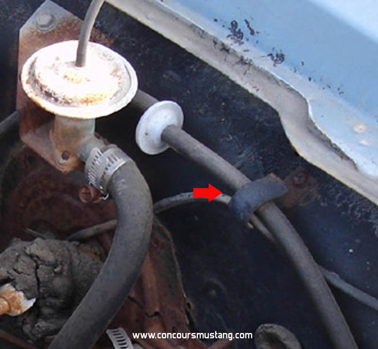

One such control valve
Ignore the arrow. Was originally posted and highlighted for another discussion
Just what I had fast and handy
