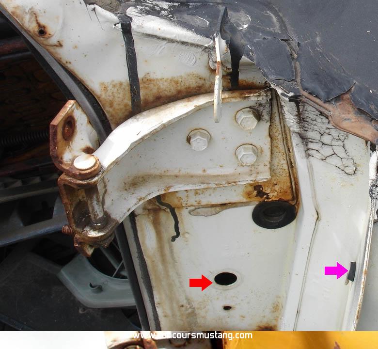

which hole in the right side cowl panel is for the radio antenna cable to go through on a 70 sports roof, a picture would be great, thanks.

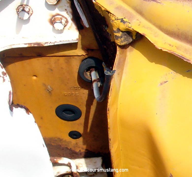

Top picture appears not to use the typical hole but does show (not the greatest) antenna cable clip  right at the grommet at the time of the picture and the grommet.
The lower picture is where they were routed through (red arrow) through. That may be the retainer clip and insulator at the purple arrow

Thank you for posing the pictures jeff, the lower hole is what i will use, it also has a small hole for a retainer clip right below it ,
