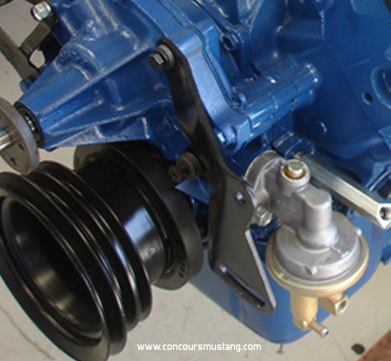

Does this help?
PS pump had not been installed yet
There are exploded views of the assembly in the MPC's and the Mustang Restoration Guide (basically a reprinting of allot of the 75 version of the MPC -- only smaller diagrams) and other views in the Assembly Manuals

Thank you a lot. On the third picture you see a spacer on the lower screw of the ps bracket. This is where one leg of the non-adjustable idler pulley is installed.
So im on the right way getting his solved.
greets
Christopher
Believe that is the only place in that region to attach it to
