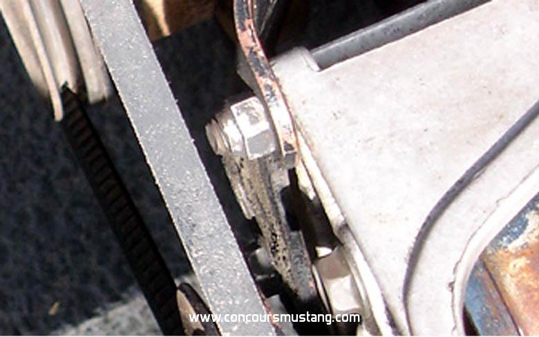

Couple of original examples - sorry can't be more specific since you didn't to include where your car was built or with which engine :(
Might want to add the info to your signature ;)
Basic locking (some call it aircraft) style nut with no washer which allows it to stay in place. IMHO  snug not really tight as it will go. I break too many bolts that way  ::)
7R01C1323xx
7R01C1680xx

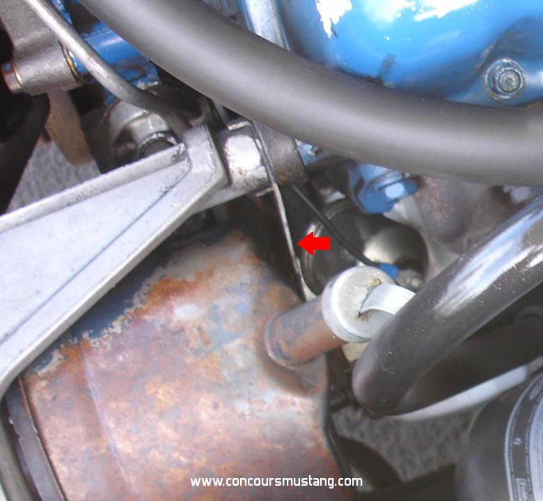

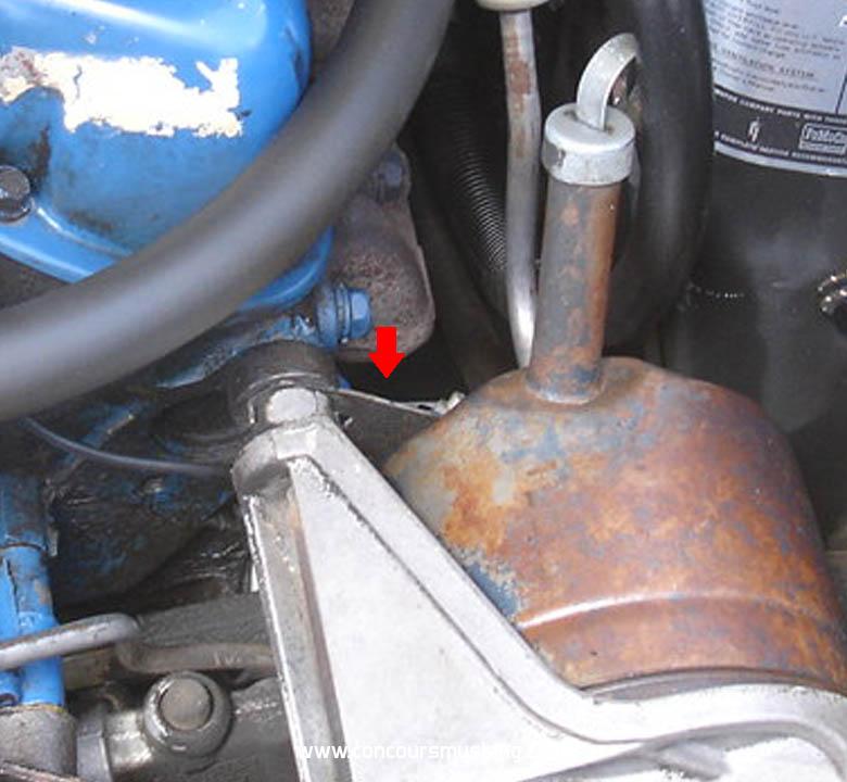

I believe the style you show in the picture is not for 67 but 68 or 69. The 67 style was a strip of reinforcement metal minus the locating aspect from the examples I have observed.

To support and illustrate what Bob was referring to I offer the following pictures of an 67 C code original example
