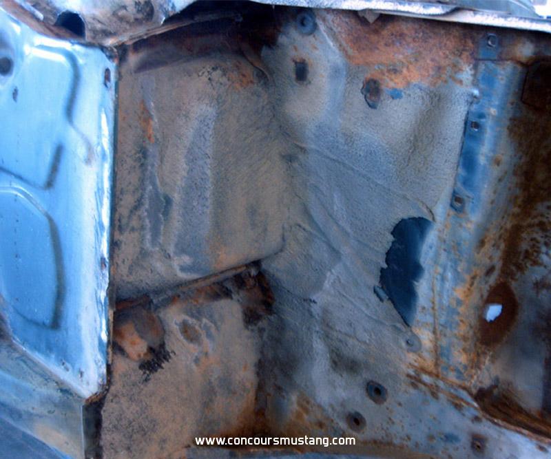

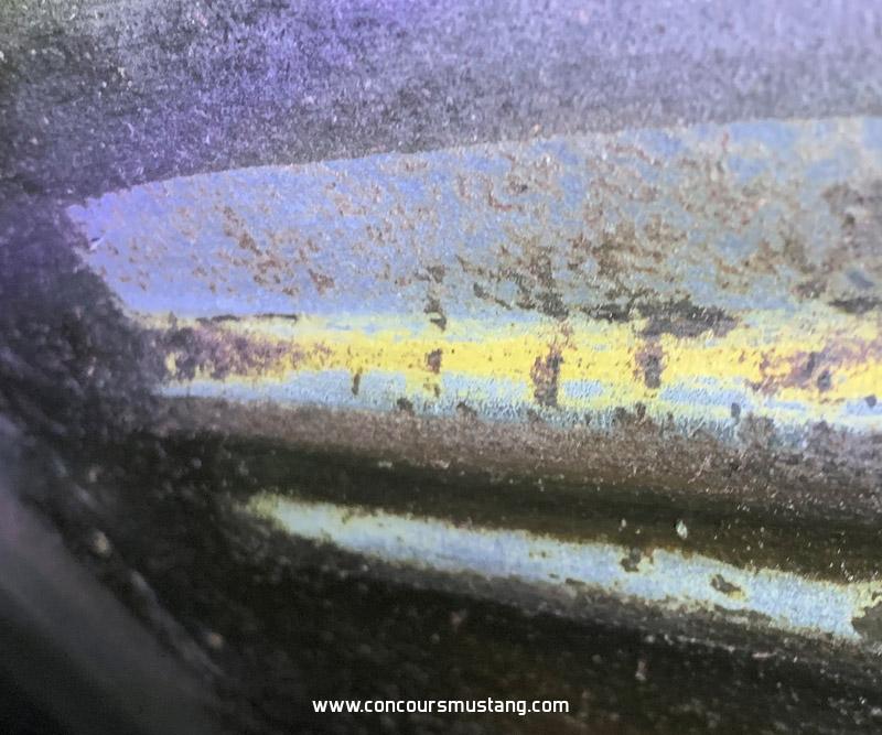

Don't have Marti reports for all my samples so will use the VIN's to at least get us in the neighborhood.  Of course we can not be certain how you car was specifically painted originally but other cars built around the same time appear to be shot, from the firewall rearward with a batch color. Mixture of m epoxy primer base with left over paint from the prior day or shift. As mentioned in multiple threads this typically, prior to 1970, resulted in a gray final look (medium to dark - most often dark) with a blue or greenish tint to an almost black look in some examples.
Below is an example from a car with the partial VIN of 8F163xxx showing a medium gray bluish color in areas where the owner/builder had cleaned away the oversprays and road grime. You can still see some of the exterior color (yellow) on one of the floor ribs

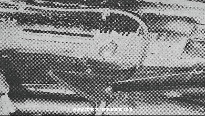

While we are here here is an original picture showing a car built about a month before yours and the amount of body color overspray (very strong) and a close applications with allot of runs from the black out paint application along the rocker panel

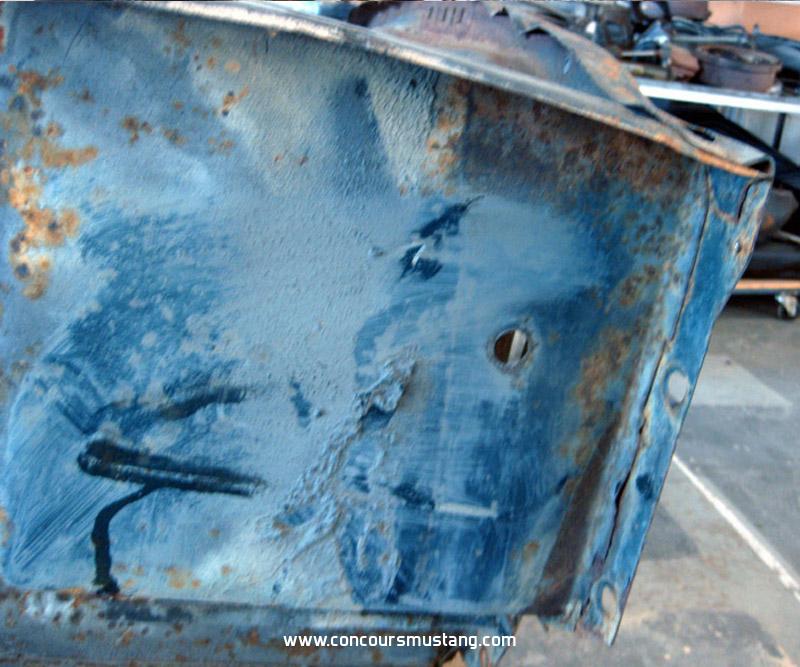

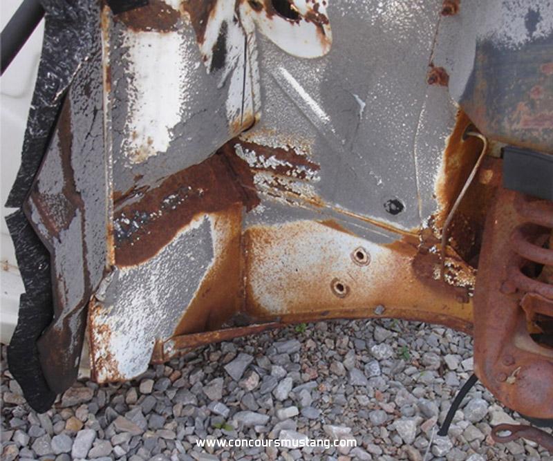

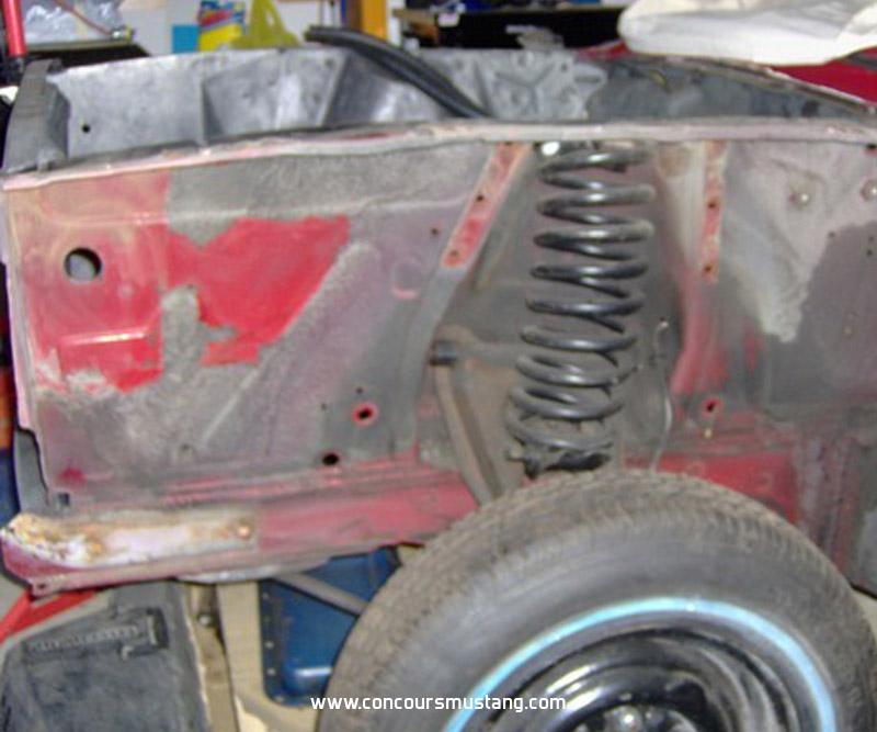

When painters at Dearborn painted the exterior they often applied the body color up to, approximately, the rear edge of the shock tower opening. In some cases a little less and on others all the way to the radiator support. When the next painter applied the black to the engine compartment and the face of the radiator support and the front cross member they often/normally continued the application of black paint onto the forward inner fender panels on the wheel well side reward maybe a foot, to the shock tower inset or to where the hood hinges were going to be attached. The rear edge was not masked nor was it straight and the painter stretched or leaned likely during the process standing lever with the body
Here are some examples showing some of the variations I attempted to describe above
Body color to the shock tower insert
8F136xxx example. With a dark exterior color the contrasts are not as great as in other pictures and examples
A ton of body color - not very typical IME but wanted to share since it did happen
