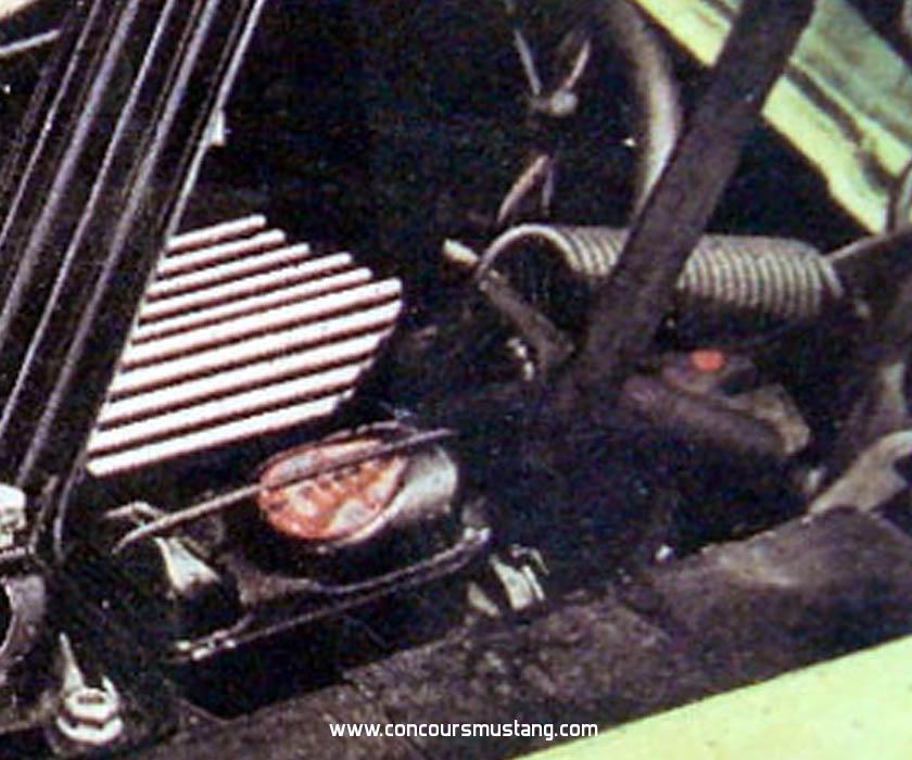

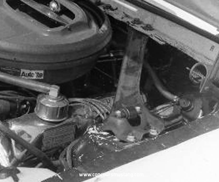

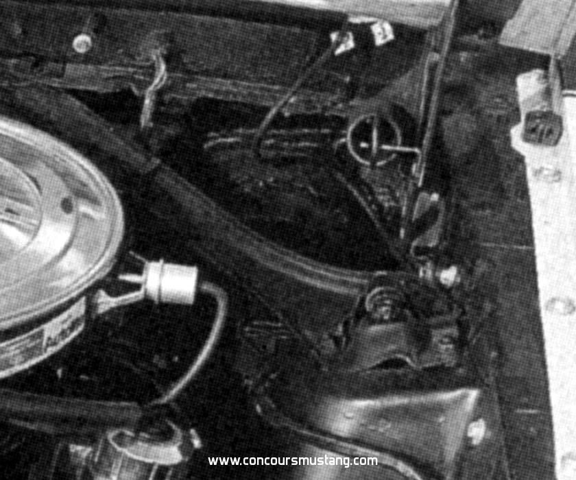

=1 - painted as a unit with the master cylinder and cap - then installed that way. Want to get concours?  The fitting faces of the master cylinder will have a small shadow around each threaded hole where a plug was in place during painting and shipping that in turn produced a shadow

Pretty much all of the classic years - Reason I left this in the general area and didn't move it to the Boss or 69-70 only area
Just a few examples using period magazine article pictures well after the release of the new models  - that there shouldn't be any proto types or advertisign cars
67
68
69
70
