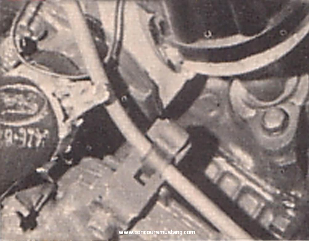

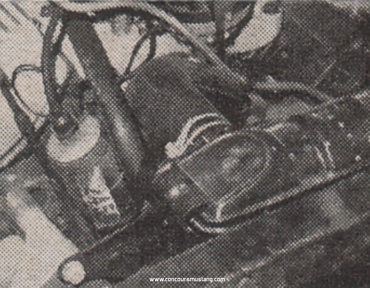

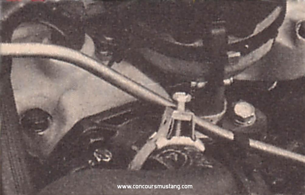

  • Posts: 24818
Re: Correct Radiator Hoses & Clamps - Early 66 SJ
« Reply #6 on: August 26, 2014, 01:02:06 AM »
Jeff to be a pain but do you have any photos? as I would love to see them both the clamps & hoses not mark Pat pending.
One recent and three from 1966

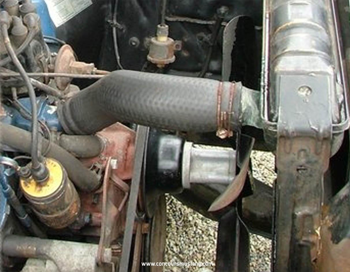

  • Posts: 24818
« Reply #8 on: August 27, 2014, 02:49:11 AM »
Thanks Jeff,
Do you have any photos of the 65-66 cross over hoses & wire type clamps?
Not sure of the "cross over" reference. These were installed at San Jose in the latter half (approximately) of 1966 production and  carried on for small block applications into 67 and 68 production
A couple of pictures from 1966 showing the "new" style hoses and clamps
A couple of unrestored examples . As an unusual note the last car is a late 66 NJ built car. Haven't seen the usage from there other than this one example. Puzzling
