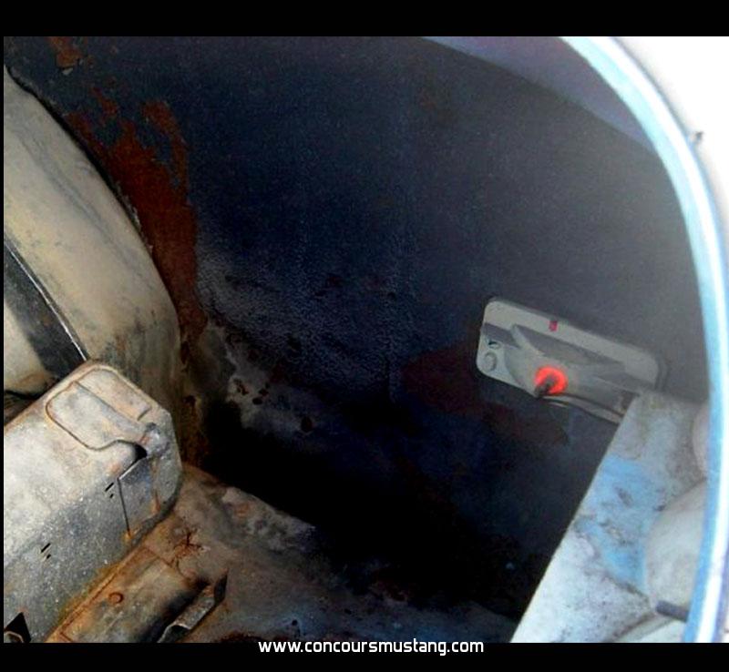

I checked and sorry - haven't spent as much time on the 71-73s collecting details. With that said here is what I do have. Hope this helps

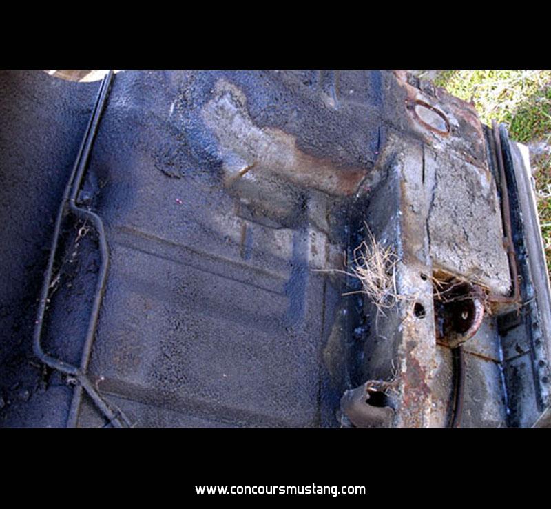

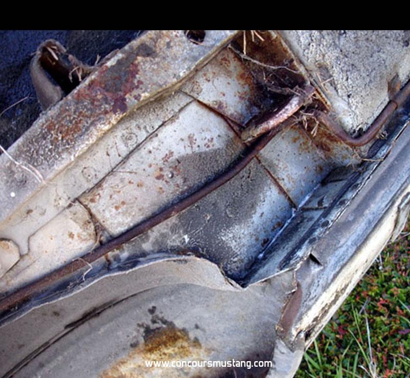

Rear wheelwells.  It appears the practice was different than earlier years with the worker typically stopping a long way from the outer lip
Splatter or overspray from the wheelwell application

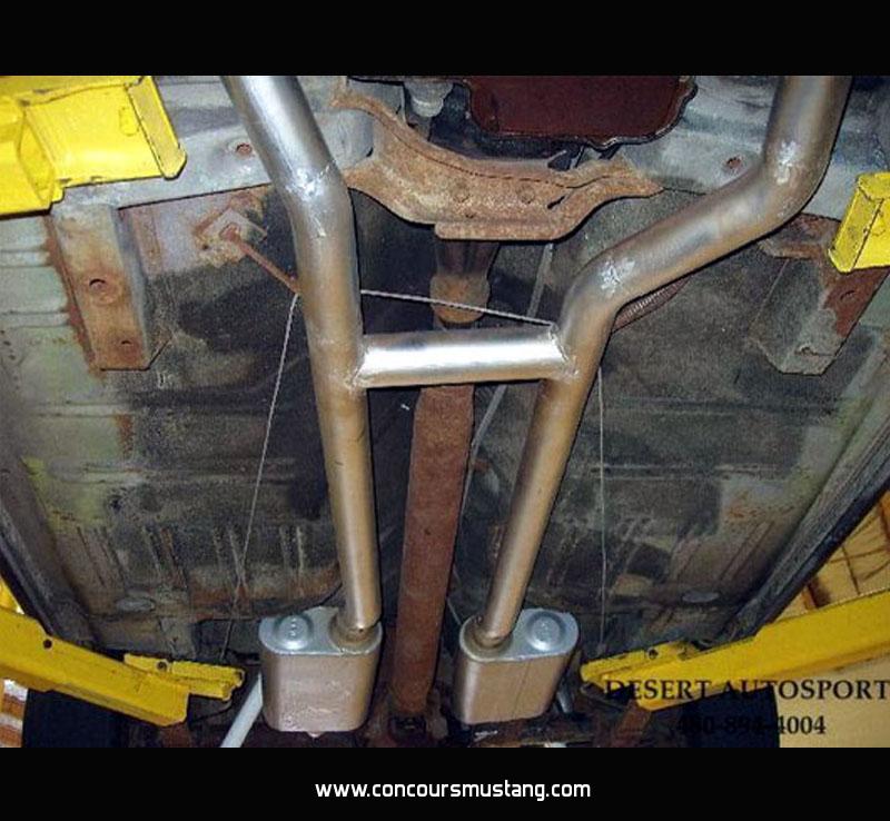

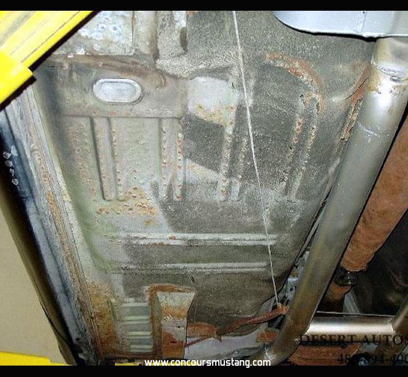

Floor application of sound deadener for Grande and Mach. Like over years it appears that it was applied after much of the car was assembled (engine, trans, brake & fuel lines, rearend and such installed ) but no mufflers or driveline.
Trunk sound deadener is difficult to see  with the tri tone (Zonotone - (s?) over the top of everything

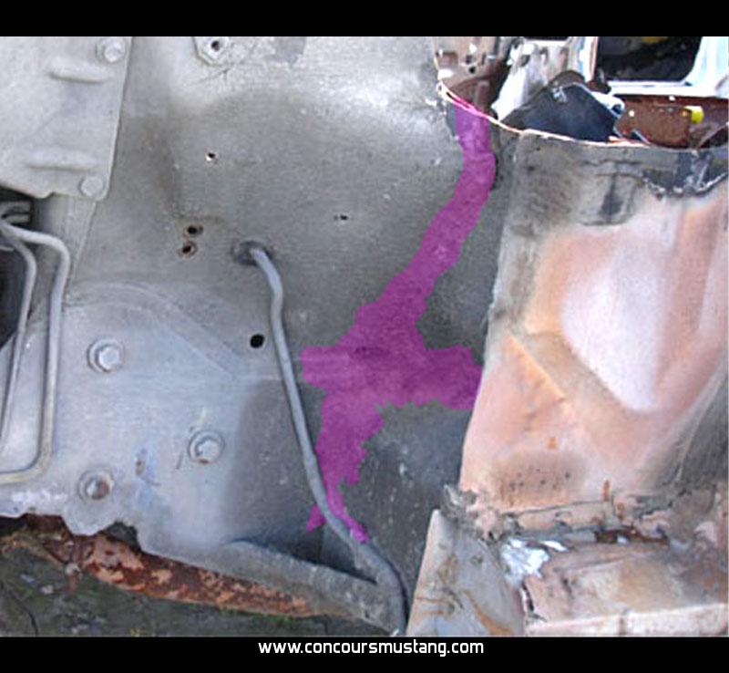

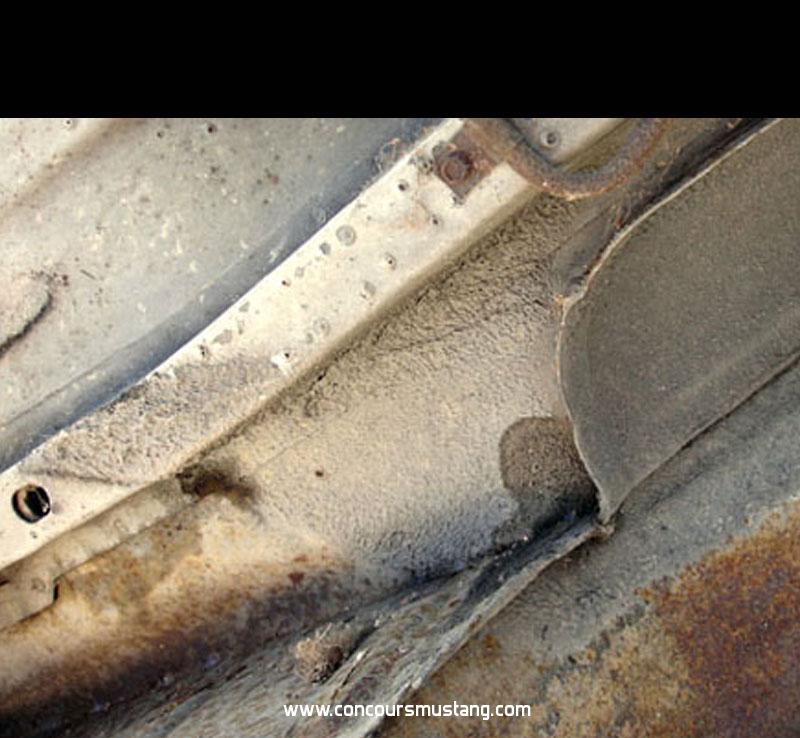

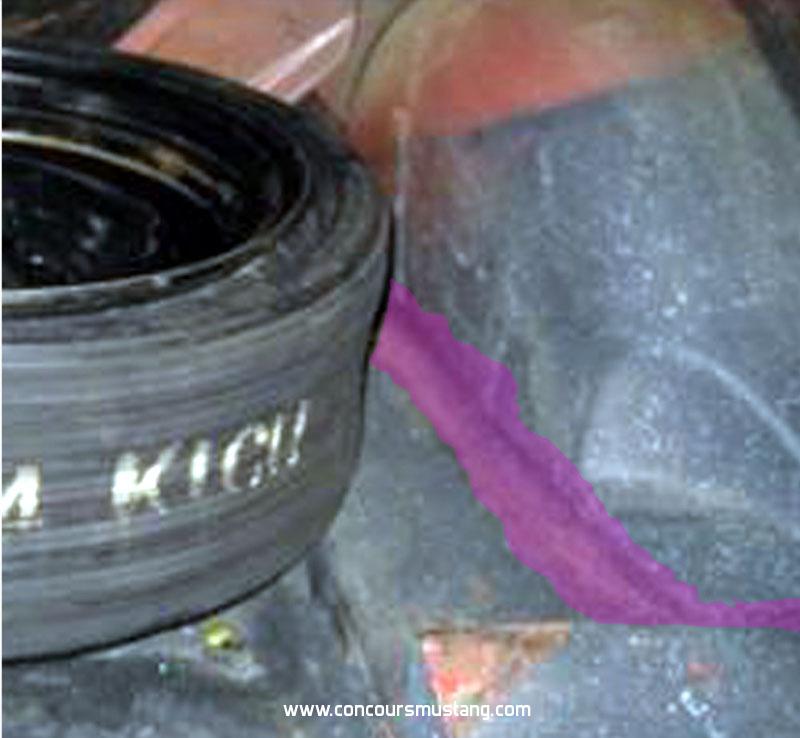

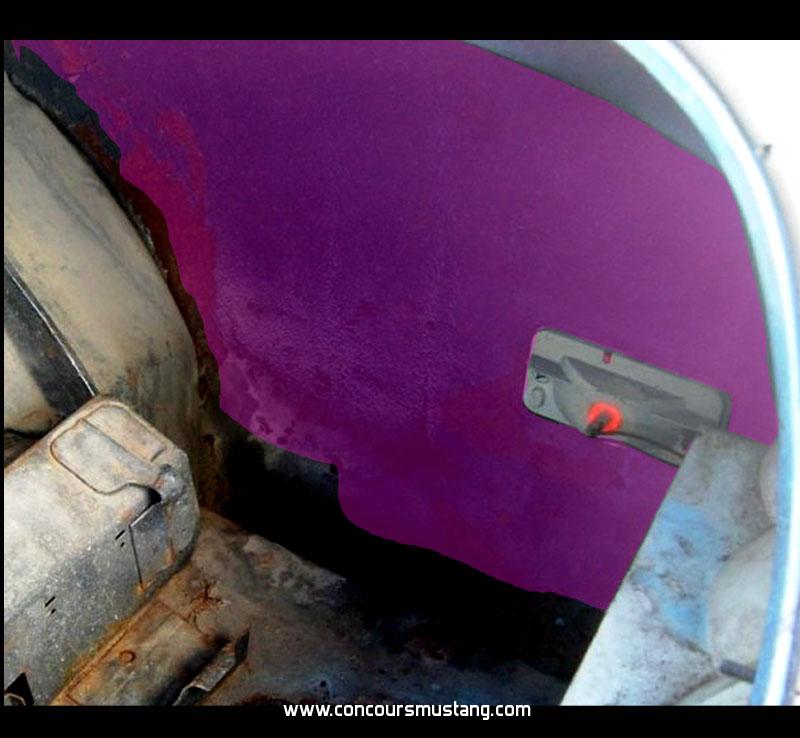

Front wheel wells were difficult to find pictures of. Like other years you have spray sealant along the rear seams then (after car was assembled - minus wheel and tires) sound deadener was typically applied to the majority of the surfaces and bottom of fender visible from below in the front wheelwell
First two pictures relate to a narrow application of spray on seam sealer prior to the sound deadener application to the front wheel well
