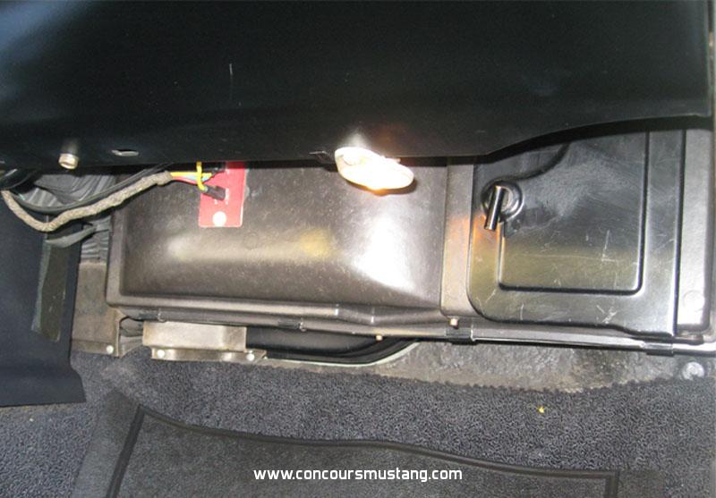

Took a look through what I have and I don't really have any late 66 Dearborn examples :(  to offer.  So leaving just one to show the left to right version for comparison
6F2056xx
« Last Edit: June 13, 2020, 03:03:51 PM by J_Speegle »

Edited my earlier post since it only showed earlier examples. But at this point it it appears that you have three examples that all support the possibility of the newer version being introduced into production during 66 production at Deaborn
Guess I need to start a 66 Dearborn Running Changes sticky and we need to continue to look and document more examples when found
