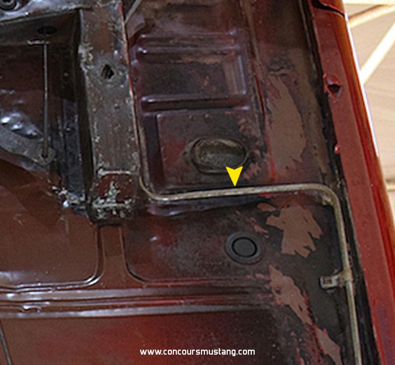

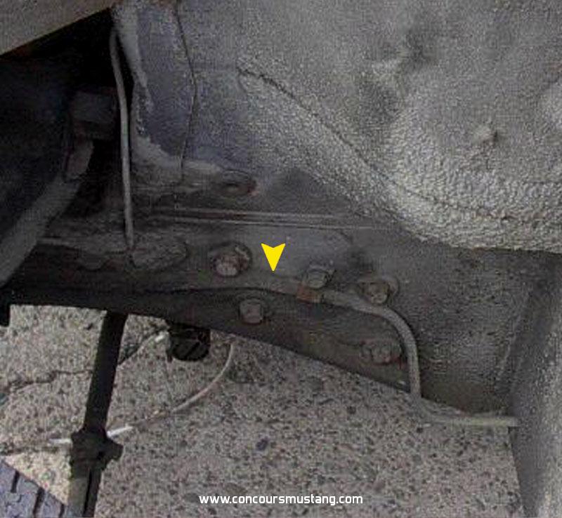

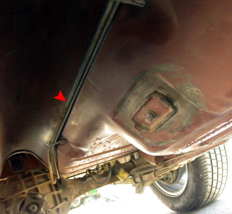

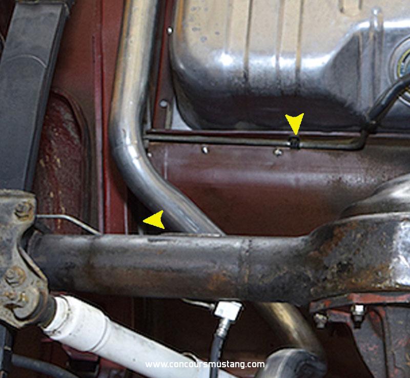

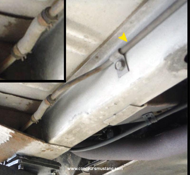

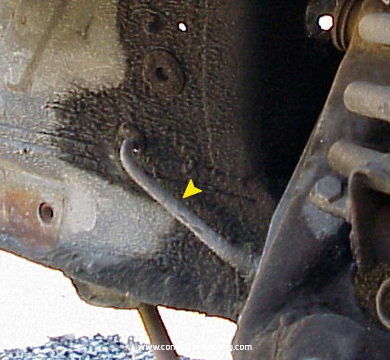

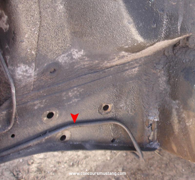

Earlier/First "inside" routing
I1- This picture illustrates a V8 equipped 67 Mustang. In this version the line is a one piece tube from this point (really the short section inside the engine compartment) to the rubber hose that attaches it, at the rear, to the fuel sending unit.
Arrows are placed in the pictures to help others follow the line along its route
I2- Along the drivers side front frame rail
I3- Under the frame rail
I4- Along the inner surface of the drivers side frame rail
I5- Past the transmission mount and aligns itself with the rear brake line and the drive line tunnel.
I6- Travels rearward down the driveline tunnel to just in front of the rearend
I7- Takes a bend out to the rear frame rail on the driver's side.
I8- Line takes a sharp bend where the floor and frail meet
I9- Follows the rear frame rail to the front edge of the trunk or gas tank drop.
I10- Takes a couple of bends to align with the gas tank mounting lip. The arrow shows that on this example the line has slipped out of the last retaining clip just before the sending unit connection.

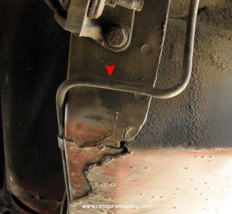

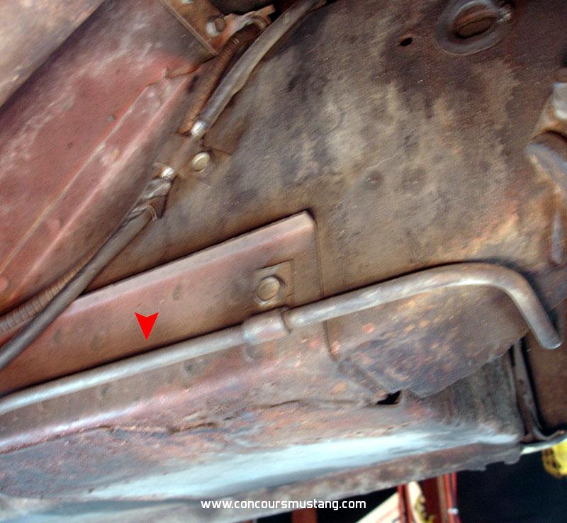

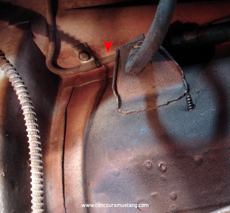

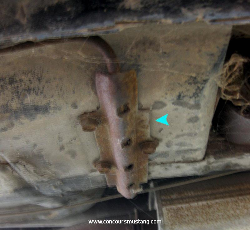

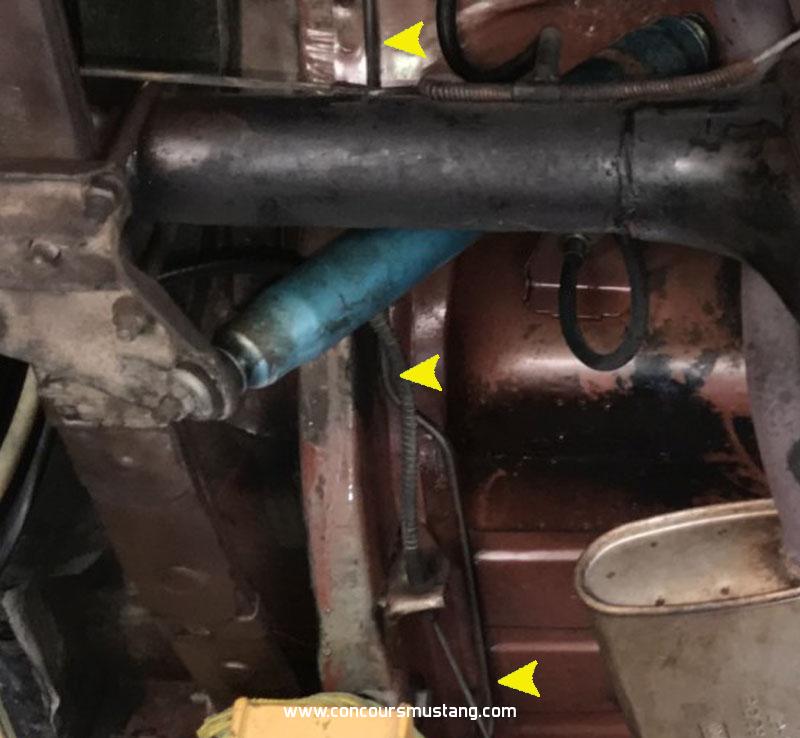

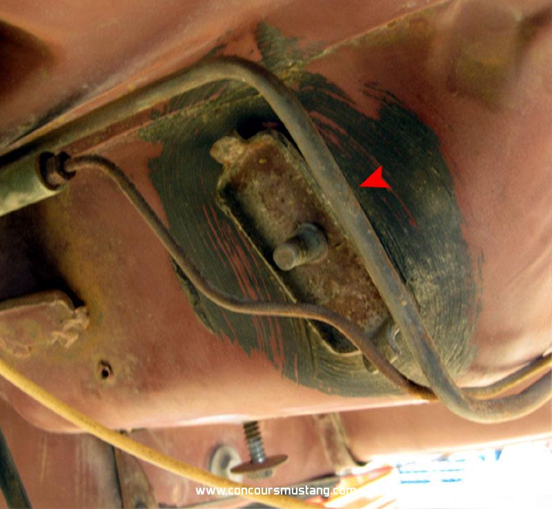

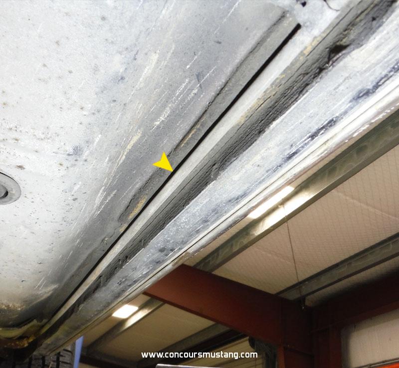

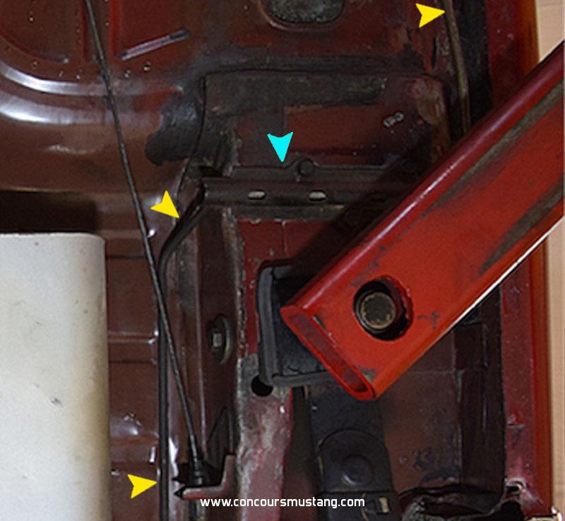

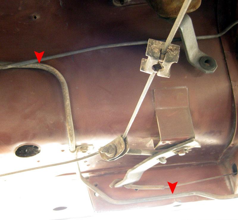

Later/Second "outside" version.
O1- For consistency I'm using another V8 car for the comparison and to illustrate this section of the route.
O2- Rear wheel well picture
O3- Front fuel line enters and passes through the drivers side torque box
O4- Exits the rear of the torque box and travels down the exterior surface of the front driver's side frame rail.
O5- At the rear end of the frame rail the long rear fuel line takes a jog and aligns itself with the rocker panel pinch weld.
O6- Line travels down the pinch weld towards the rear of the car.
O7- At the rear spring front mounting plate in the unibody the line turns inward and passes under a fuel line guard. Marked by the blue arrow, then takes a turn parallel to the rear frame rail.
O8- To the rear of the emergency brake cable mount the line bends over to the inner frame rail surface and travels rearward to the gas tank drop section of the rear/trunk floor.
O9- Line finally bends towards the center of the car, following the lip of the gas tank floor opening to the sending unit.
