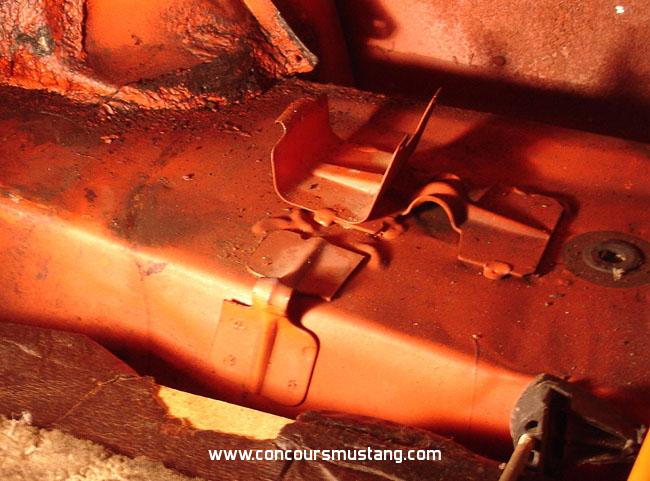

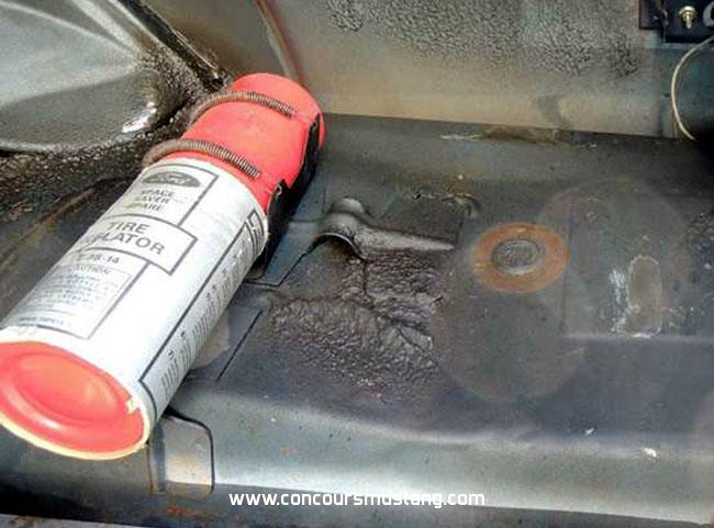

Some examples of space saver brackets and finishes. Sealant depended on the worker. Appears at least one of the guys was not doing his job 100%
Both from the general production period
0F1516xx - 0F1573xx

« Reply #14 on: May 21, 2020, 09:13:34 PM »
Thanks Jeff, yup no sealant on both brackets on first picture, must have been a Monday.
