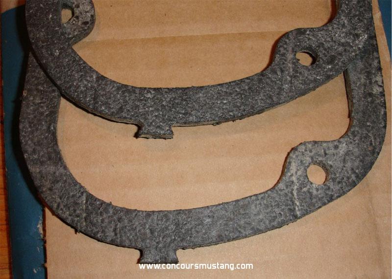

Wow that's an extremely helpful picture Jeff, yeah this is a mustang, but it does have the dress kit on my car, so I still assume they would look like these still, correct? See attached closeup pic of my cars valve covers, this was something you mentioned I should fix when you saw my car at SAAC 43...
Ok now we're getting down to the details that matter and the reason we often ask so many questions before we offer advice. Too easy to chase the wrong detail  ::)
Since your car is using the cast aluminum COBRA valve covers when I would suggest ( as described to you in person) what Bob and Charles wrote above since different gaskets were supplied for that application. As shown below.If your car was built/restored as you originally wrote (with a few details left out :)  in your first post - 66 k Code  then the coated look is what IMHO you would be looking for and as found on unrestored non-dress up kit equipped cars.
Definition is not really great in the picture below but it its meant to illustrate that the top and bottom surfaces were black while the outer and inner surfaces were natural cork. Basically the gasket material coated black before the gasket shapes were punched/cut out of the base material
