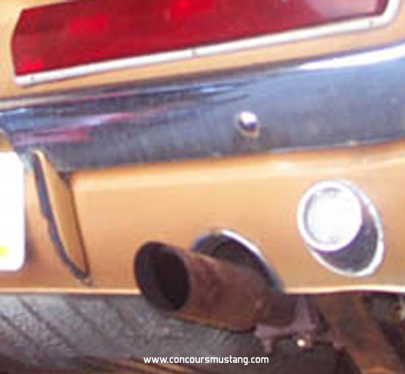

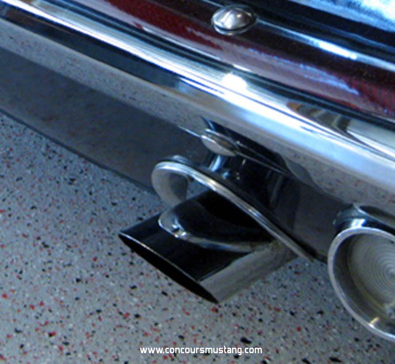

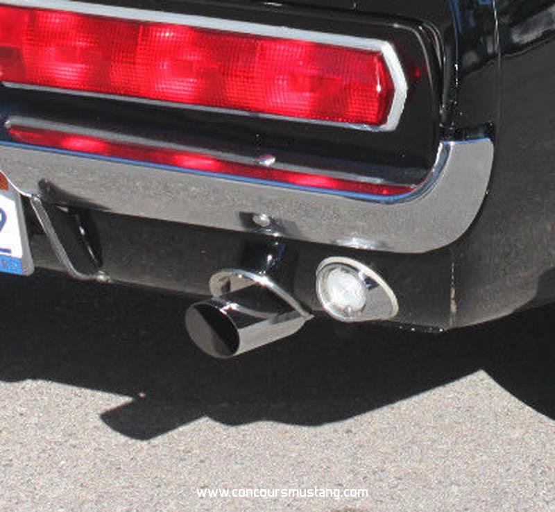

A interesting 67 rear valence tidbit. Shelby American had to improvise to begin with on the blank rear valance because of the duel exhaust exhaust tips used on all regular production 67 Shelby cars.   The early production cars had to have the rear valance cut out by SA employees and modified with a made up trim ring using left over 66 exhaust parts because the duel exhaust rear valance had not been released yet. Once Ford released the new part the Shelby's were built at Ford like all other Mustangs that got the duel exhaust rear valance.
That's pretty wild!  I've never seen one equipped like that, with the '66 style trim reused on the '67 valence.
Too much junk, too little time.
  • Posts: 24620
Re: '67 Rear Bumper Guards with Dual Exhaust?
« Reply #18 on: October 19, 2017, 11:02:00 PM »
Here are a couple of handy examples of this early 67 Shelby practice. Not to get to far off thread
