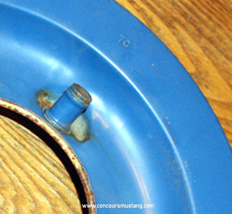

To illustrate these three versions I thought we would benefit from pictures of each
No Nipple- Paint color applied depends on application.
Large Diameter Nipple for closed emissions
Small Diameter Nipple - opposite the formed/stamped depression in the base
