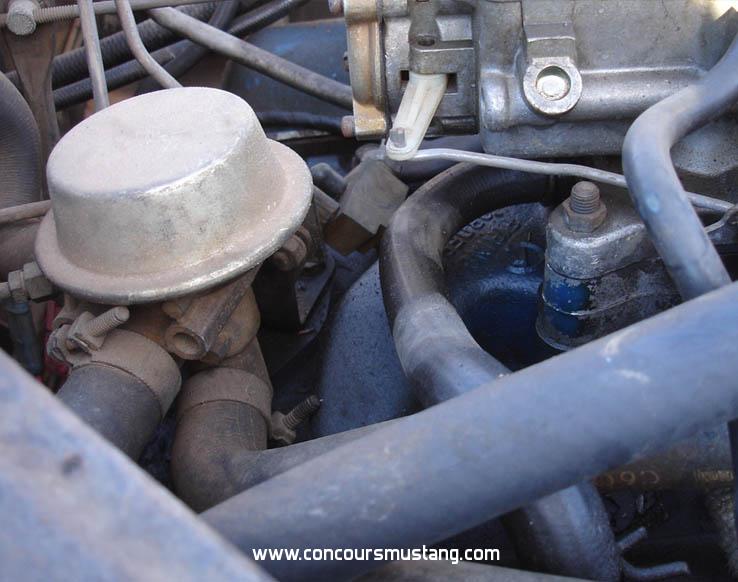

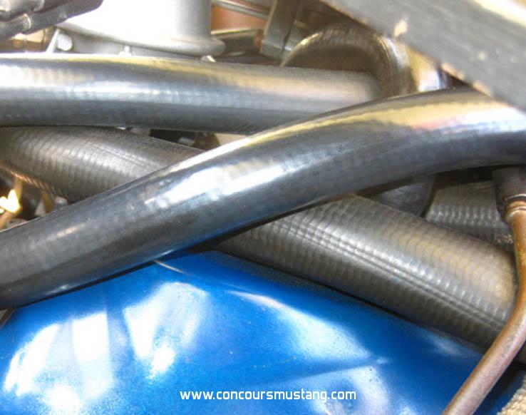

Sorry for the delay...Bob Mannel  Mustang and Ford, small block V8.....6K13...special fitting at the PCV hose on all automatics, replaced with the hot idle compensator valve if a/c installed.  I got the part in case it was original to my car.  I'd rather not install it if it was not, per my postings.
Appears that you may not need it
If you read the next page you will see that that system and layout was "which quickly superseded"
This arrangement/attachment spot is different from many original examples where that hose goes to the pump since they used the other two port Thermactor valve. In that version the air cleaner attachment does the job of the PVC attachment
Bob's book makes reference to one system replacing the other  the first is noted on page 6-39 where you can see in the pictures the layout I'm referring to. (additional pictures below)  Because of this not all cars would have received the block for the compensator. So without the block there was no place for the compensator on those cars which it appears make up the majority of production
Both of the following (could post more) are A code, auto, thermactor cars.
6R07A1147xx   so it was pretty early in production when the change was made
6R07A190xxx
