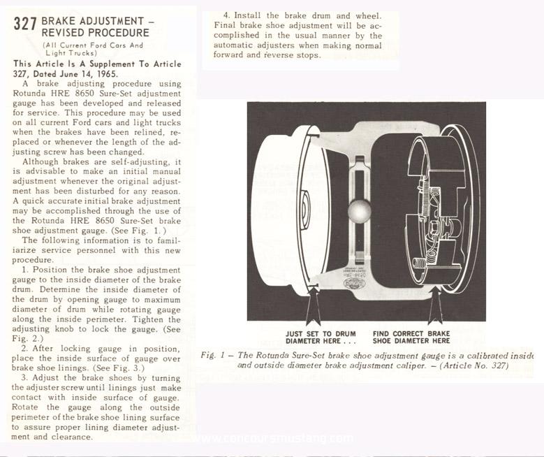

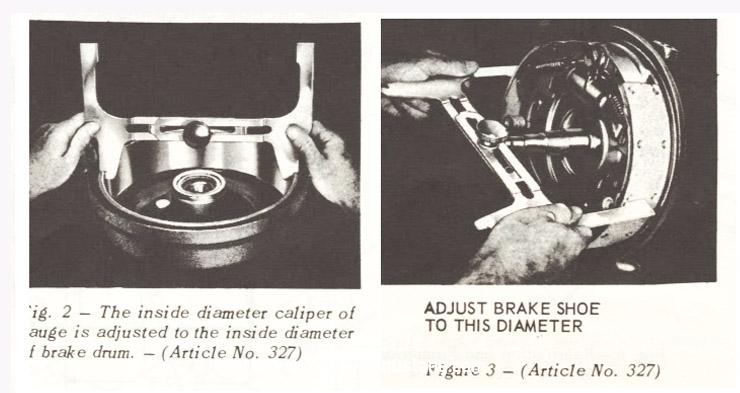

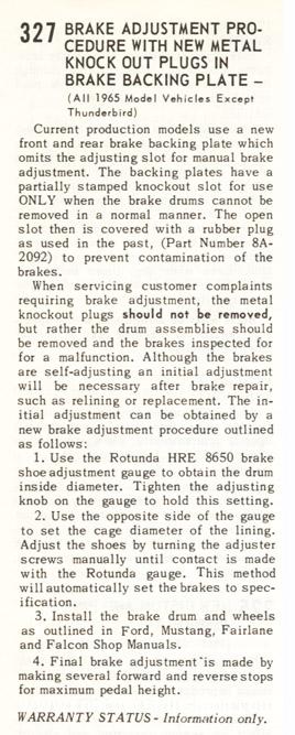

Realized I never posted the TSB that announced this change and the additional information Ford published to show service personal how to measure and adjust the drum brakes using the Rotunda gauge as was done at the plant.
Information and illustrations have been reorganized to better fit the chosen format
First TSB-327 Published June 1965
And the follow up information published in the next TSB collection sent to the dealerships and shops.

The original TSB was dated June 15th 65. Indicated also in post #7
The June 15 65 date is when the TSB came out. I wonder how many months logistically it took before Ford discovered that they had a problem and needed  to pint a TSB. I don't think it is likely that it would be simultaneously with its 6/15/65  put into implication date.
