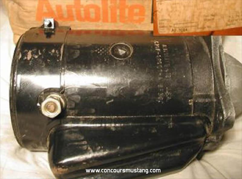

Any pictures of unrestored starters would be great. Details I wish to see include the small block ink stamp for Auto Trans car, paint transition or fade to the aluminum nose cone to try and duplicate factory details (maybe make an ink stamp too?)
Build date of 11/2/1966
Somehow I get the feeling this ink stamped version (below) is generic, not correct

Ok - lets deal with the finish/paint detail first Some examples that have been posted in other threads

The stamp on the starter in your picture looks like someone took the current reproduction sticker and had a stamp made from that. IMHO not even close in many ways.
From earlier discussions we see that the ink stamp and stamping into the metal case likely overlapped for a number of months - different plants doing different practices for a while.  Latest AUTOLITE ink stamp examples I've seen was May 67. Those starter likely were installed on cars during June and possibly into July or later.
http://www.concoursmustang.com/forum/index.php?topic=11000.msg66530#msg66530
For your application I do have a Oct 66 stamped starter picture which indicates that by that date the supplier had moved from the FoMoCO stamp design to the AUTOLITE design.
