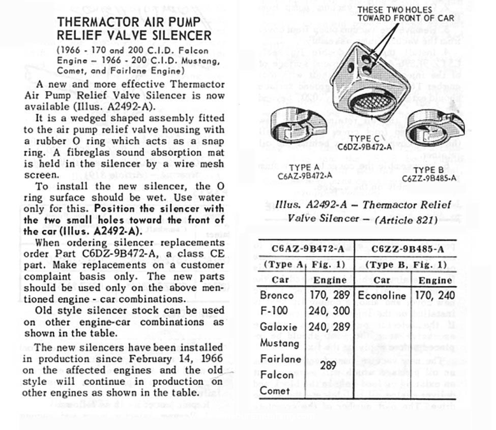

There are a number of different applications and time period affects the type and style of "scoop" used originally. Some applications (V8 included) used not while others used the little round style and others the large triangle style shown in the first picture.
There was also a Technical Service bulletin that showed how the scoop opening was orientated or should be
Will see where that stuff is hiding

Here are the factory notes showing the different styles of "silencers" and details including a new one added in Feb 1966 production. Hope it helps explain another detail related to the 1966 Thermactor system for the 6 cylinders

Josep, From what I read in Jeff's TSB information, it looks as though your inline 6, since is built AFTER the February date, would originally have had the wedge-shaped silencer , NOT the scoop type, is that the concensus here?
  • Posts: 24818
Re: Part number.?
« Reply #11 on: September 03, 2016, 06:22:47 PM »
+1
That is what Ford reported in 1966 to their dealers and service shops and what we've found on original cars we have pictures of - unless there is no scoop/silencer (fell or taken off at some point ;)

I'm working hard to find one of those, but not an easy job.!
Got the scoop type already, but looking for the wedge-shaped one.
