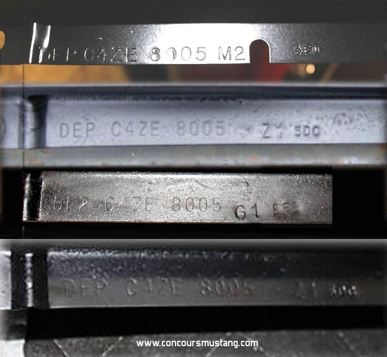

I also found an example of a radiator purported to be Dearborn radiator (Radiator 65 V8 Dearborn, auto trans, DEP C4ZE 8005 - M2, date 4ED) which I'll provide images of as well.  I would have expected to see the radiator information stamped on the driver's side not the passenger side. This particular radiator has rounded corner tank straps like the generally accepted shape for a San Jose radiator.  In addition, general consensus is that the Dearborn style of radiator has rounded square corners.    This particular radiator doesn't match my timeframe but the top of the tank straps are similar to those on the radiator in my late July 1965 Metuchen built factory AC car (with some minor exceptions).

I also found an example of a radiator purported to be Dearborn radiator (Radiator 65 V8 Dearborn, auto trans, DEP C4ZE 8005 - M2, date 4ED) which I'll provide images of as well.  I would have expected to see the radiator information stamped on the driver's side not the passenger side. This particular radiator has rounded corner tank straps like the generally accepted shape for a San Jose radiator.  In addition, general consensus is that the Dearborn style of radiator has rounded square corners.    This particular radiator doesn't match my timeframe but it's a deadringer for the radiator in my late July 1965 Metuchen built factory AC car (with some minor exceptions).
Ron I'm assuming that the pictures you posted are from this example you mention
A few things I notice when comparing it (basically the side strap and the stamping) to know originals is the following
1- The side strap in your pictures has a notch for some reason half way between the two mounting holes that I can't find on the originals I have pictures of
2- The design of the fonts are different - most notable  IMHO is the number 4  Then there are issues with about three other digits that don't seem to match as well as the hesitation marks.  ::)
Here is the one you posted and some examples I have for comparison. In any cars I hope yours is not a "a deadringer" for the one in the picture :)

Thanks Jeff - My radiator doesn't seem to have any stamping on the sidestraps (at least that I can see with it installed in the car). To answer a question asked earlier the tank strap is rounded (but different from the San Jose design in that the end curve is squared off).  I've attached a picture for reference (passenger and drivers side).
PS - I agree that the font and the kerning in the samples that you have vs. the example I provided are definitely different.

I pulled one of those squared off curve radiators from my car many years ago. I'm guessing it was a Ford service replacement. The original owner of my car kept service records and looking through them saw he was dealing with a radiator leak around 60k miles. There are no dates stamped in the tank or W MO, just flat.

Thanks for all of the input guys - especially @Autolite.  Do you have additional images of a date appropriate radiator for my late July Mutuchen Built car?  Based on all of the input I'd conclude that I have a service replacement rad.  This is thread has been very educational / helpful.
