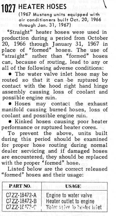

As a follow up, while going through the TSB articles the other day researching another question for another member/thread I ran across a bulletin that stated that the formed heater hose was replaced by a straight one for a period of time (end of 67 period if I recall correctly)  Know people are possibly purchasing parts based on what they read here so wanted to mention this fact as soon as possible. In the days to come will post the complete TSB article so that owners can make the most educated choices for their restorations

Jeff, when you say formed are you referring to the 4' long hose?
A quick view of the wording suggest yes the long hose was involved in this on AC equipped cars built between Oct 20 1966 and Jan 31 1967
No explanation is given for why Ford used (made the change) during this period

As promised :) From a March 1967 bulletin. Not sure why they made this change in production for this approx two month long period but there it is
