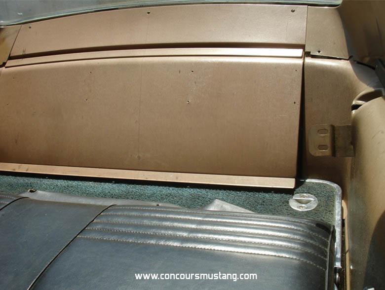

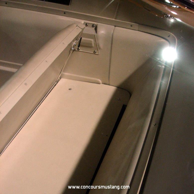

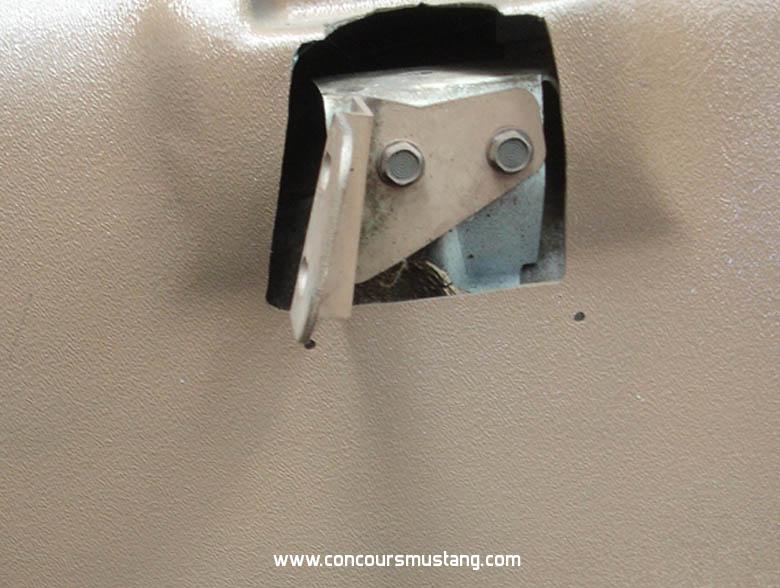

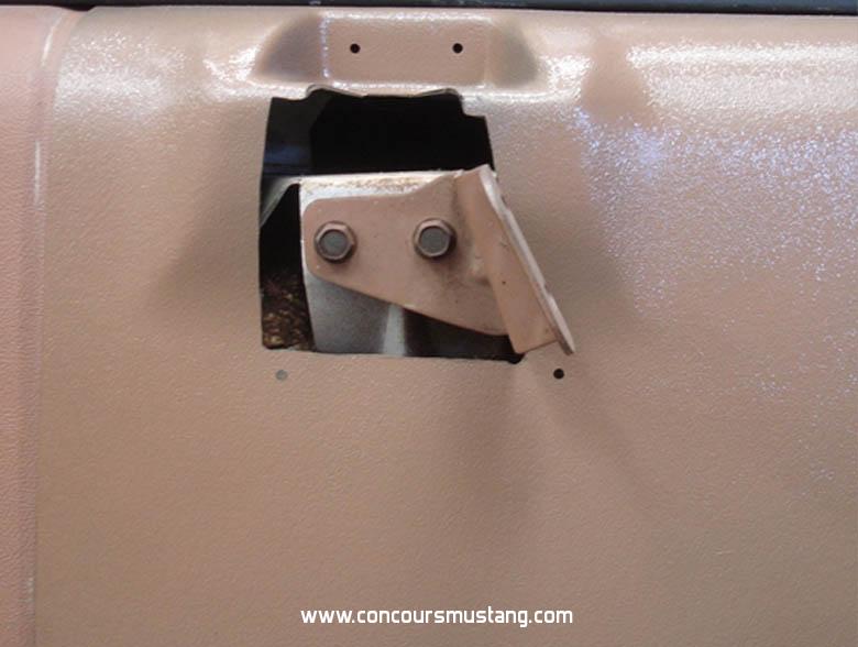

Fair number of differences between the fold down and non fold down in 67-68
Trap door is more of a single sheet of metal rather than having a face and a rear liner. The total panel is slightly larger also as shown in the picture (ignore the carpeted rear panel and the speaker screw holes)

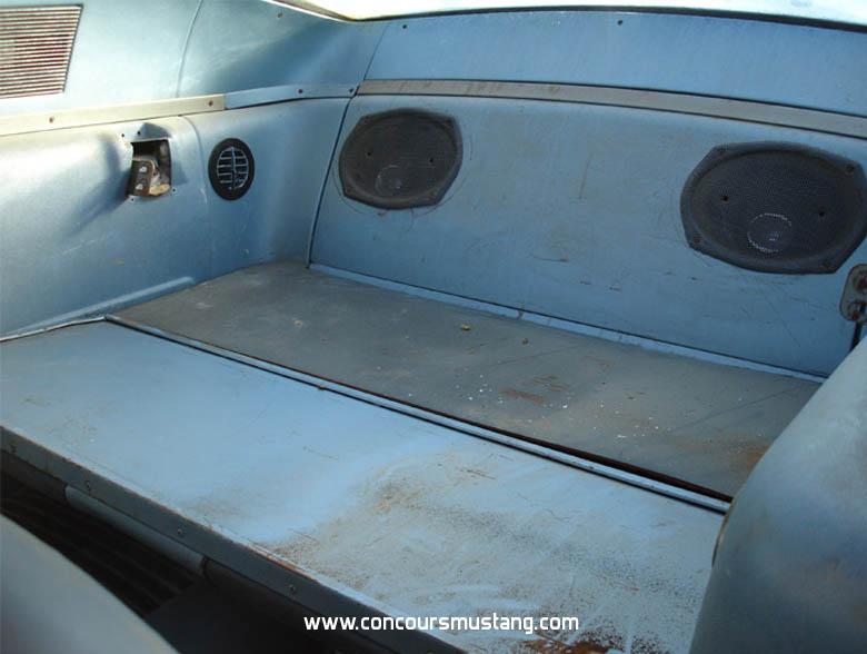

A section of painted masonite replaced the rear panel (compared to the carpeted and trim metal panel used on fold downs) Please ignore the PO added speakers and vents :(
Side seat latches were replaced with a single L shaped bracket on each side bolted to the rear seat section to keep it upright
On the later 67 and 68 fastbacks a latch cover was made that is different from the fold down style

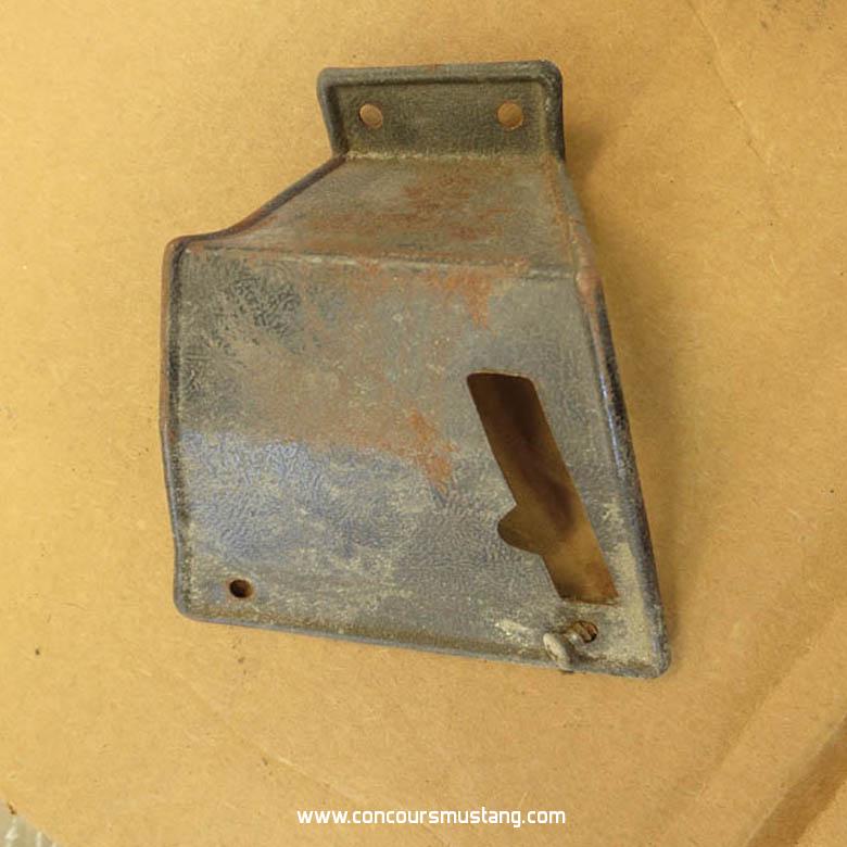

Offline tlvenne

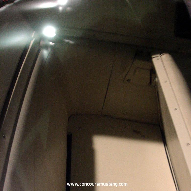

I have seen two latch plate styles as well, one has more of an outward shape to it. Shown installed in one of the photo's. The other is more flat, shown in the photo of the lone latch plate. Guidance on when/why those were changed?

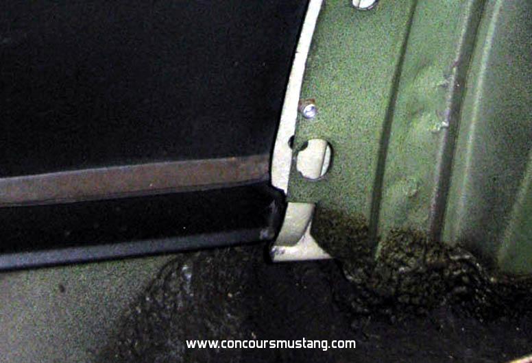

Another question, I can't identify what is the piece at the bottom of the trap door. Anyone help? Some pics show a gap (missing piece I presume) and others show it. Like many of the small pieces, I am guessing this will be the hard part to track down and I will need to begin my hunt for it. I just need to know what exactly it is called.

Jeff, You're the best! I really appreciate these and they are exactly what I need.
Yes noticed that also (flat verses with the bump) also the very early may have had no covers and small cut off's like the fold down style. Not enough non-fold downs at this point to figure out when the change or why (plant to plant) yet. If you had included when and where the car was built we could at least have looked closer at cars close to the same date as yours and same plant  ;)

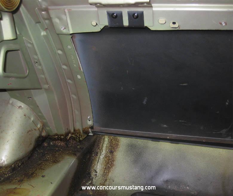

[/quote]
The small trim edge at the bottom kept the panel from being bent (no hinges at the top) forward of the owner detached it at the bottom
Not sure if it has a "name" but will look at some other pictures to see if its a separate piece and other details

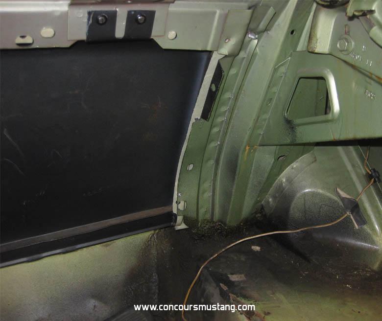

tlvenne Checked and I don't have a clear picture of that lower edge to determine if its welded or attached in another way to the bottom edge of the filler panel that covers over the trap door opening  :(
All I found was a fairly close up picture of the two panels together in the trunk of a nice unrestored 68 San Jose example

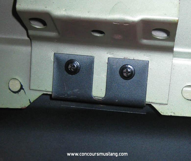

The lower formed piece is spot welded to the upper section.
There are also at least two different mounting hole configurations for the Masonite piece. One that has holes arranged to mount to the pads over the shock mount crossmember and the other with holes around the perimeter.

Another photo' request if it is readly availible, does someone have a photo of the back side of the filler panel, from the trunk? I am curious what they look like on the back side and how they are different from the trap door.
Unlike the trap door which has a face and back (trunk side) panels that are pinched around the edge this is a single piece of sheet metal that makes up 90 plus percent of the filler

« Reply #13 on: January 17, 2016, 02:01:13 PM »
Photo of Masonite filler panel attached
