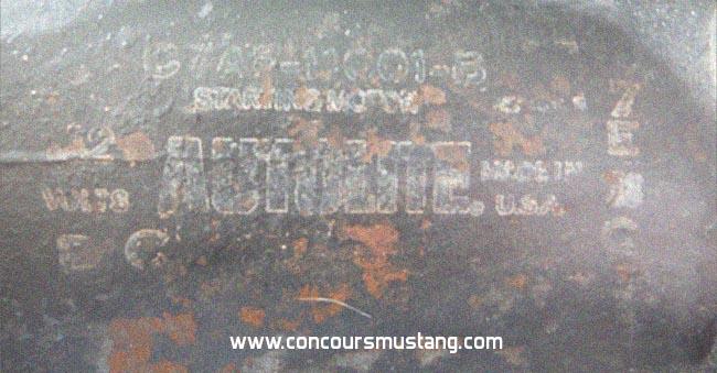

Small block picture but big block one would be in the same location. The easy route besides applying the sticker would be to make a ink stamp of your sticker. The sticker is not correct when compared to original but how many people could tell? Or you could come up with original artwork for a stamp. Apply the ink stamp to your starter and forget about it. Otherwise start looking for that big block metal stamped date code correct big block starter .  Just some thoughts .

+1   Latest small block starter I've seen with the ink stamp was dated Dec 66. And yes the stamps were dated - unlike the reproductions you often see or the decals :(
As an update - Did dig out a 67 starter today and found it ink stamped 7E18. So at least one later date though, from examples, they likely overlapped (ink or metal stamped) depending on supplier.
BTW the ink stamp was not the rebuilders AUTOLITE stamp style we see on some NOS ones floating around ;)

I've been digging through a few starters I have and find I have two early barrels with no stamped in markings and the rest are stamped D2s with D2 noses.
After reading a number of posts and finally seeing this one it gives me hope that my SJ Hipo car (Mar 2) could use the ink stamp, the plain barrel and that I could copy Jeff's pic of the ink stamp (with a date of approx 7B).

Since it is correct one would hope so ;) Very hard to see sometimes on a big block but a small block is much easier.
Don't just copy the pictures I posted. Age and wear has erased many details you don't want missing on the finished product
