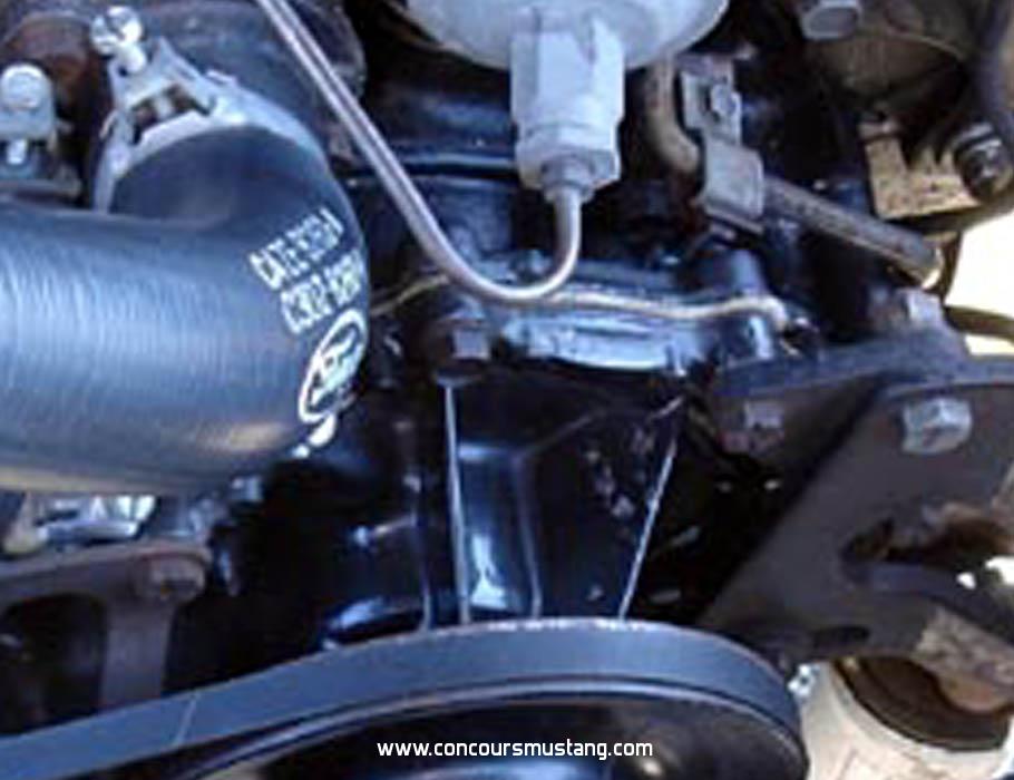

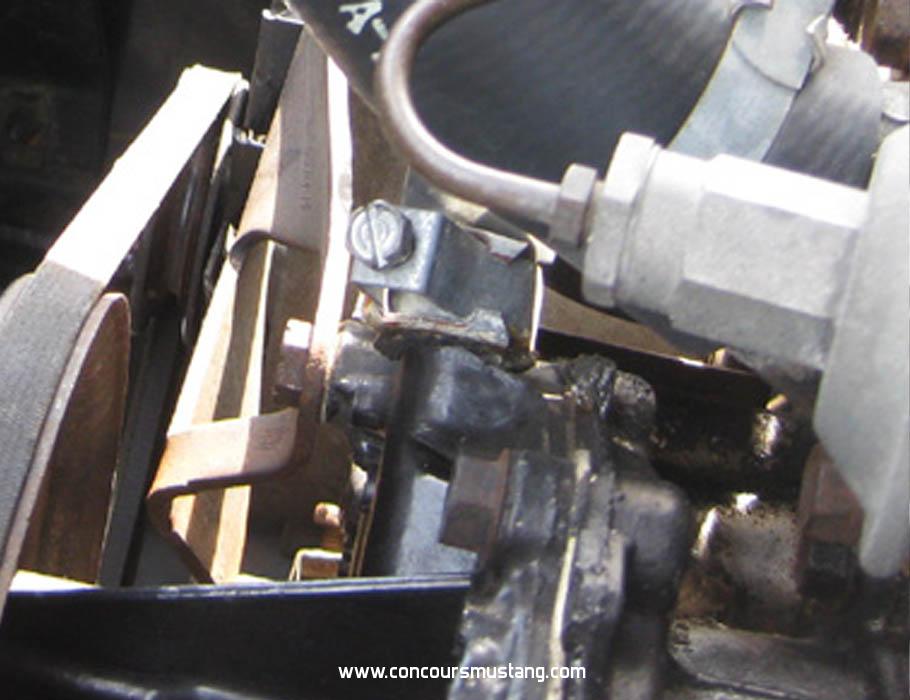

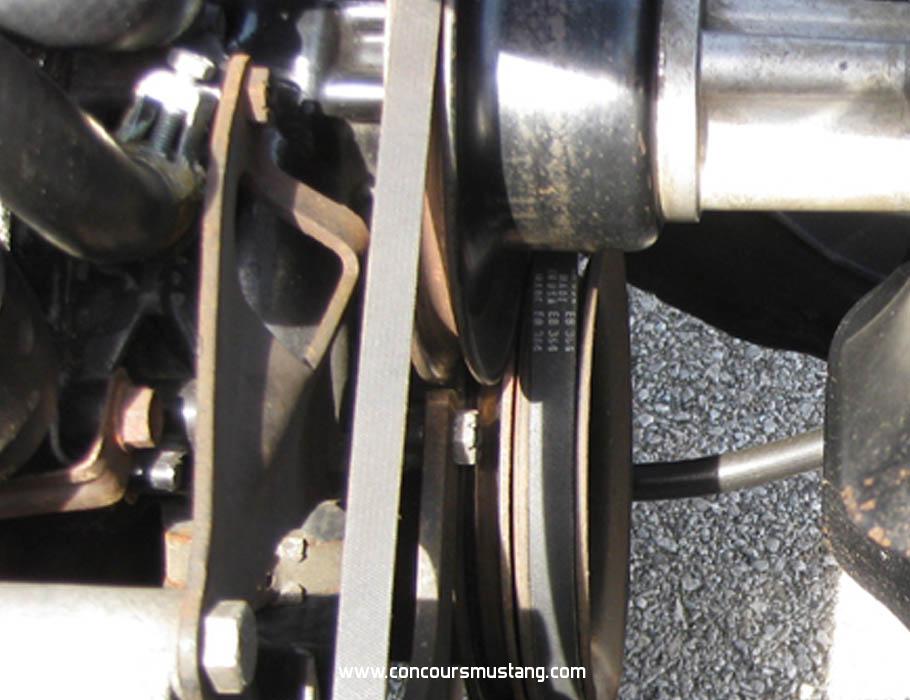

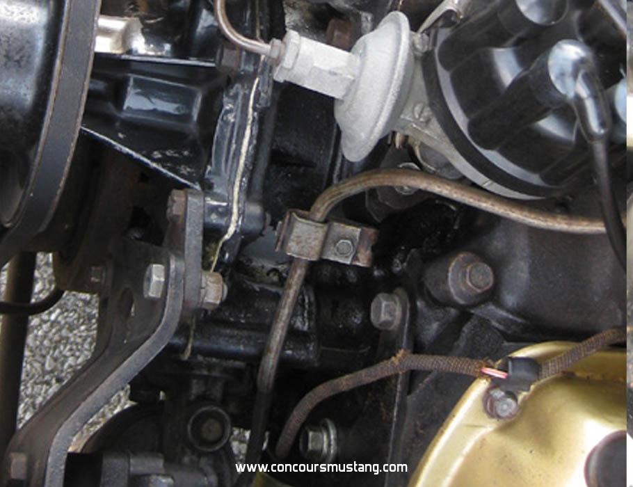

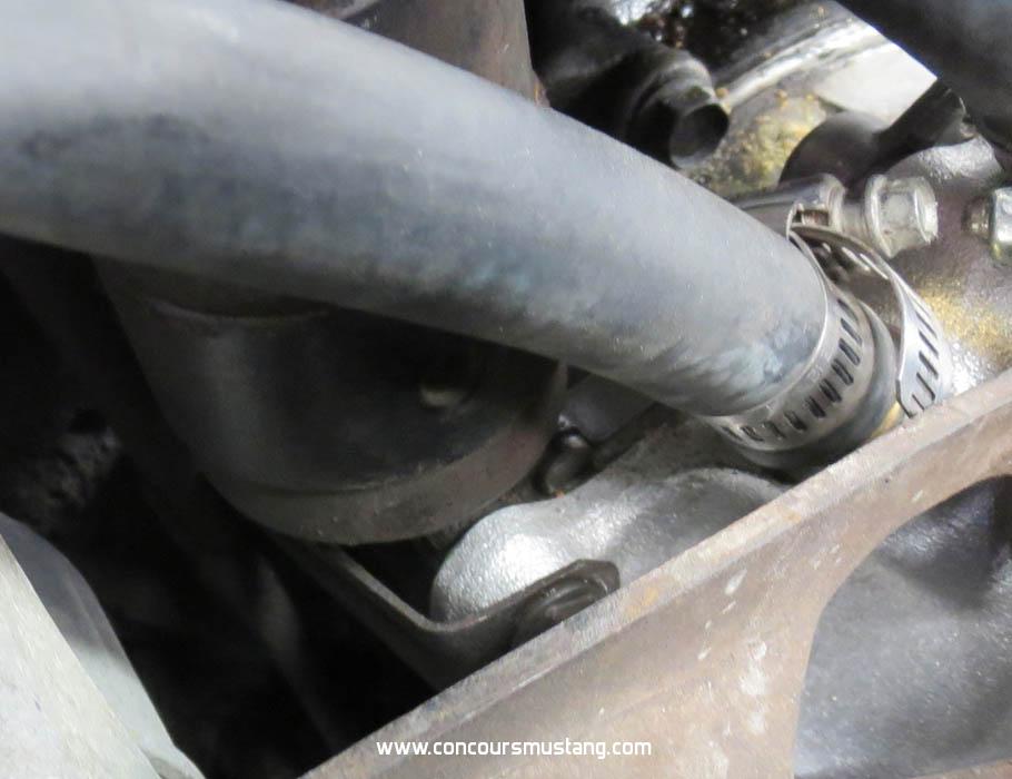

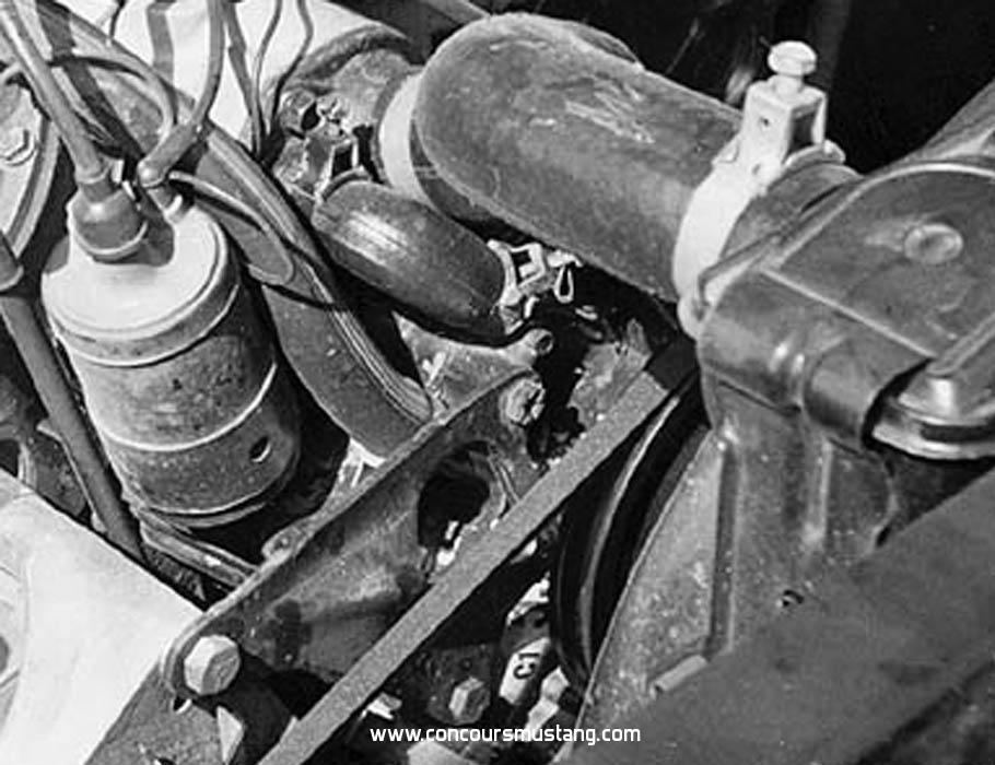

« Reply #1 on: February 16, 2015, 12:26:30 AM »
A few pictures that might help
Thanks Jeff.  Great pics!  I can see positions 1 and 2 from those, and looks like both match what the kit has.
